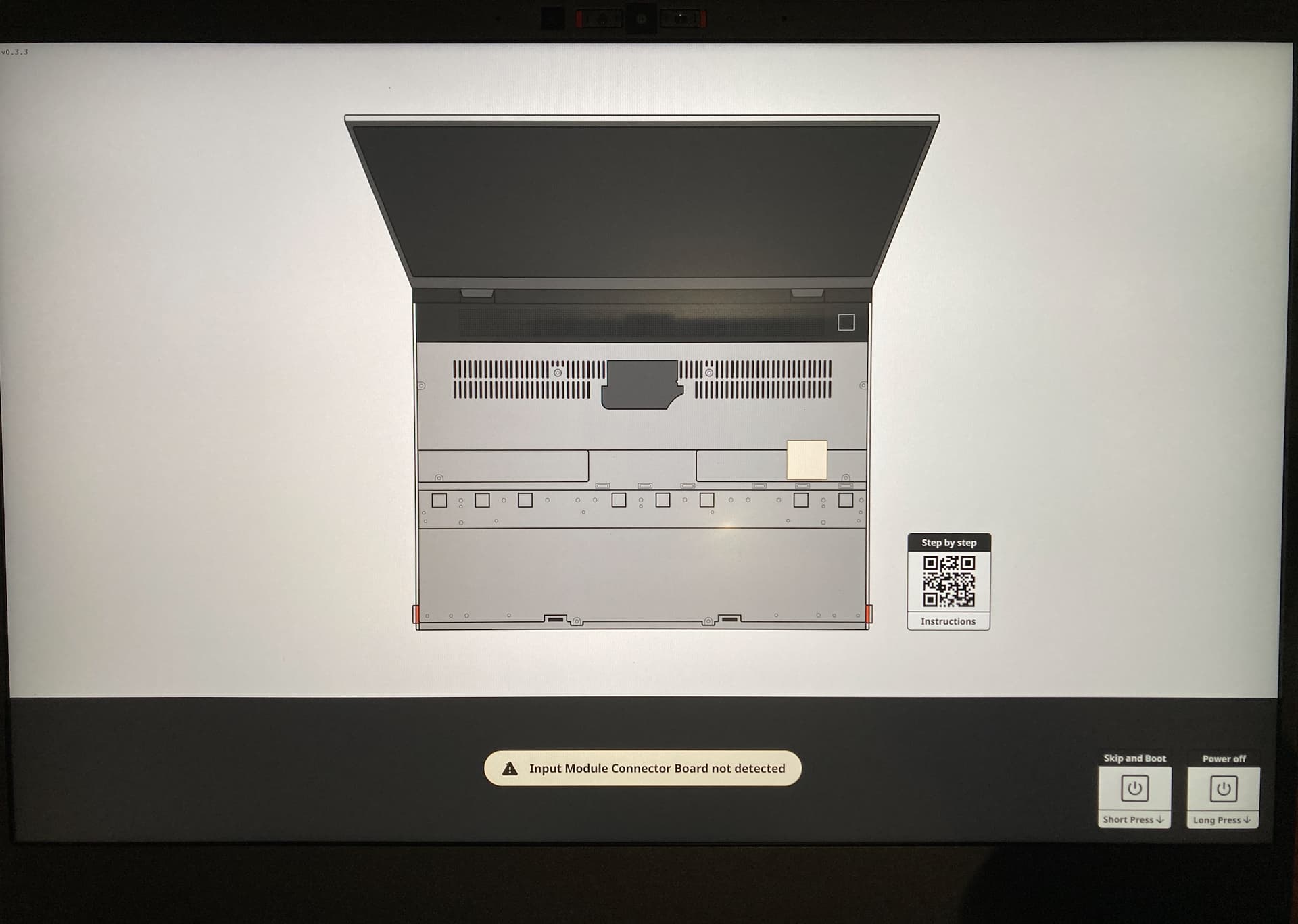

The laptop is stuck at : Input Module Connector Board not detected.
I found one other post that mentioned this issue. One helpful person mentioned that all components had to be put back onto the mid-plate. That helped, because after unscrewing and screwing back many times, I had stopped putting the touchpad and spacers back, to save time.
But I get the same error when all pieces are in place.
I don’t think the mid-plate connector cable is damaged (it looks like the mid-plate connection had a soft adhesive, not hard glue that would break). What are my options?

I eventually found that the ribbon connector could be inserted a bit further. That solved my issue. Also, I got a replacement.
