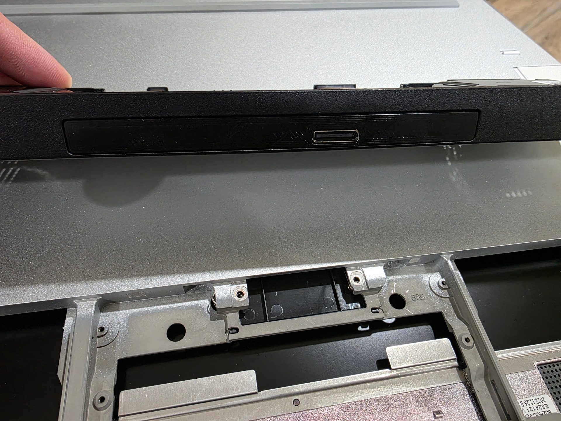

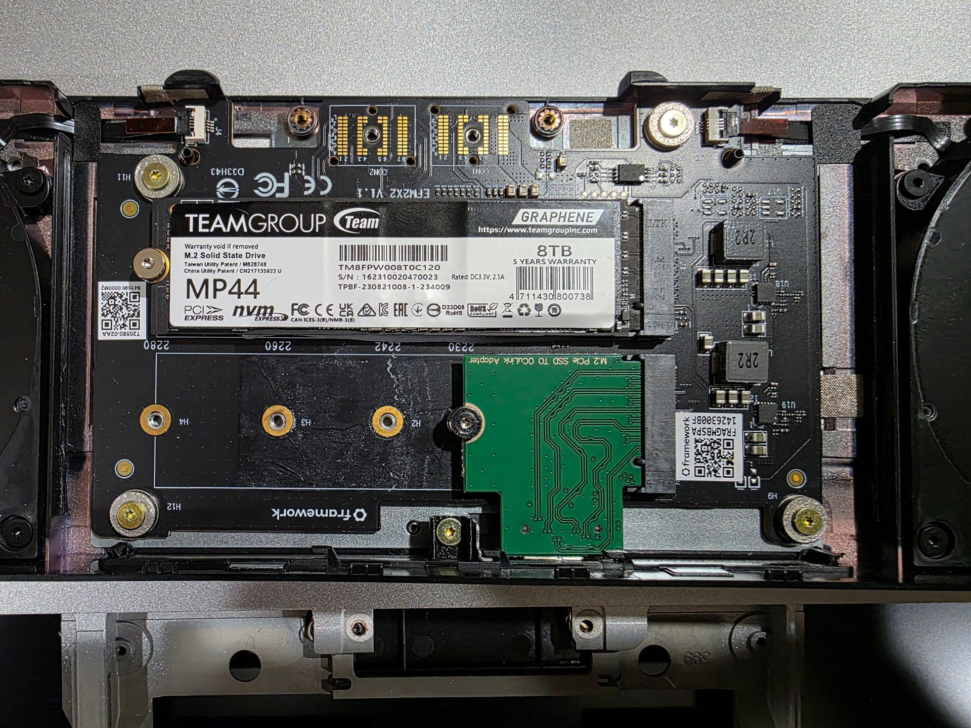

Figured I would post this here from the other thread..
Here are some pictures from my installation.
8TB! Nice! That for the Steam library? :laughing:
I have a 2tb boot drive and 2 8tb storage ssds. I’m a datahoarder. Need it for music, music videos, anime, shows, movies. Blu-rays and 4K Blu-rays especially take up a lot of space. I keep the compressed versions on my laptop and the uncompressed ones on my NAS.

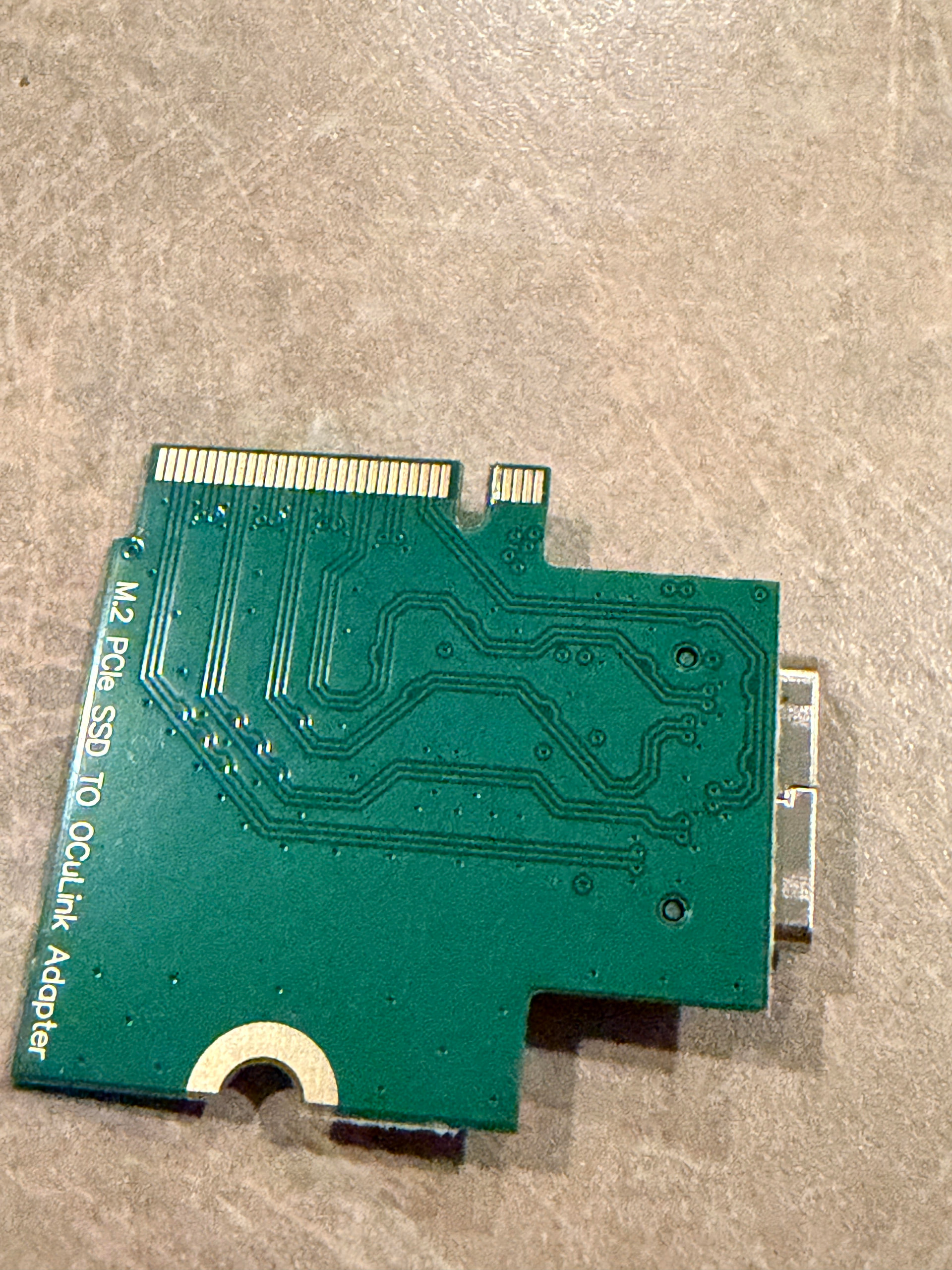

Got my adapter in. The adapter and plate fit perfectly. I wont be able to test GPU performance and reliability until after the first, but I will post results when I do. I will be using an RX 7900 xtx.
I have followed up with Kyle directly already and he suggested getting some feedback on the 5th pad on the right side of the key. Looks a little funky and I won’t have my expansion bay and m.2 board until after Christmas so I won’t be able to test it, but given how it looks, what would you guys recommend? I am on the side of thinking it’s potentially fine, it doesn’t seem to cross over onto another pad but we both wanted to get your guys’s opinions on it before we place it into hardware.
My .2 cents, will likely be fine. Should still provide connectivity. Won’t know real results until you can actually test it though.
