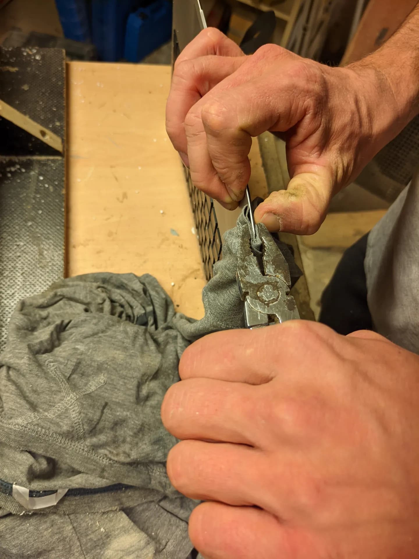

It took me a while, but better late then never! I managed to fix it together with my DIY guru in November 2023. In the end, the only tools used were pliers, hammer and a vise. Following pictures in chronological order:
  1. Bottom chassis with everything removed:
  1. Coarse bending back into original shape using pliers + piece of cloth to minimize marks:

I have to admit that in reality it actually looks much better than on these pictures:) Overall I’m very happy with the result, mostly people don’t even notice.
