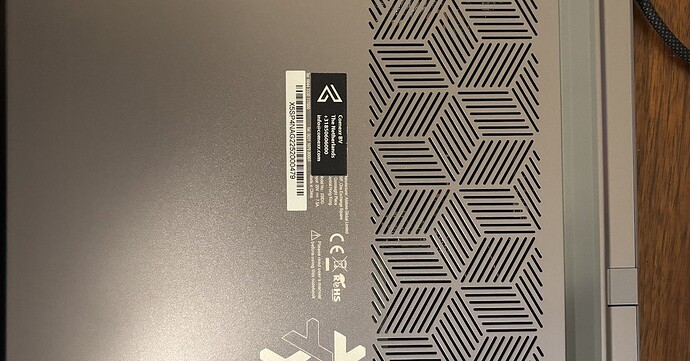

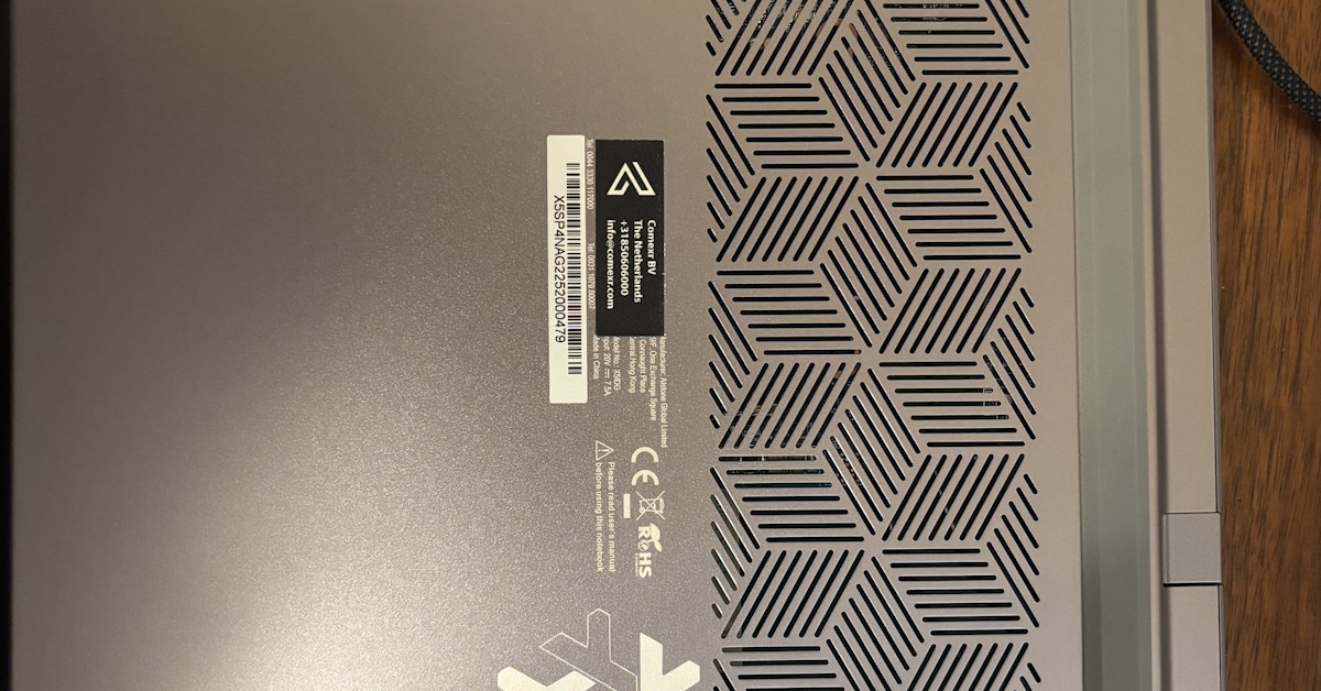

I’ll be doing a test on aluminum 6063 for the top cover later this month and I’ll update!
