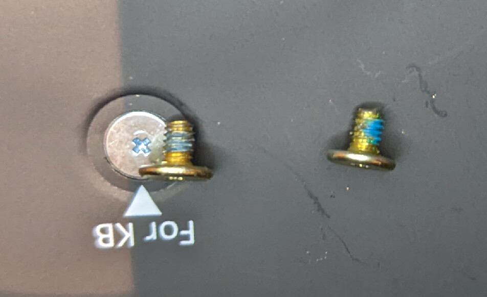

… and here’s what the WIFI and SSD screws look like when removed for the install. No point in adding my own adhesive if they ship with some from the factory:
Thanks, @Framework !
