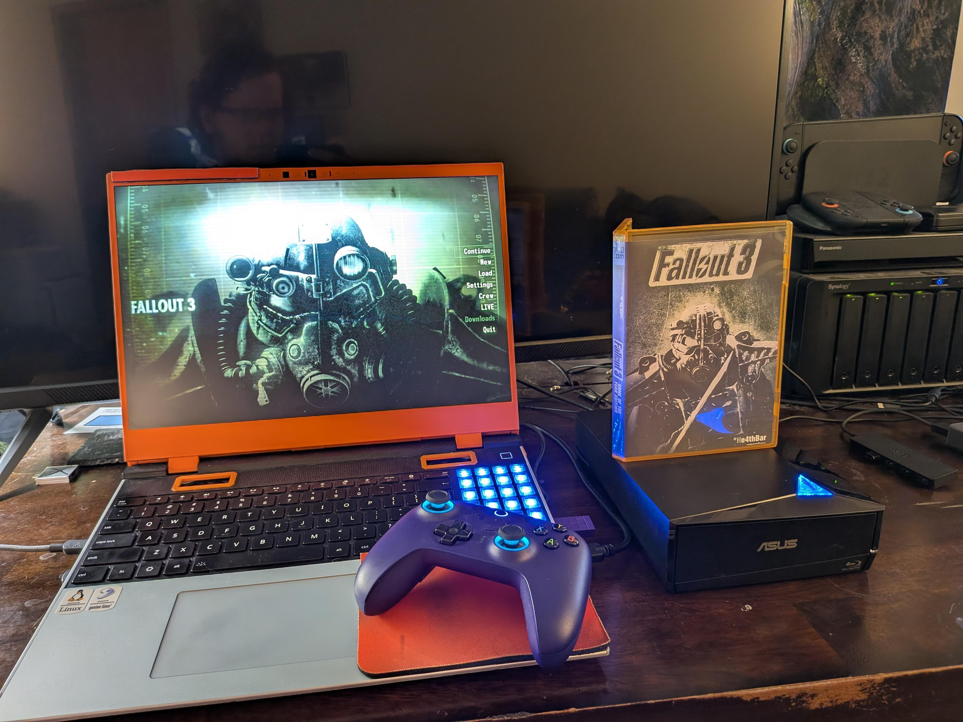

Made a true physical copy of Fallout 3 and turned my FW 16 into a "console"
This is a little off-topic, but I thought it was still in the spirit of what Framework is about (plus, I used my Framework for the project).
This is a photo of my framework 16 laptop booting from a Fallout 3 GOTY (GOG) blu ray. I made it by taking a gentoo live install disk and:
* removing unnecessary applications
* adding lutris and its dependencies
* installing Fallout 3
* seting up an auto configuring persistent storage system for game saves
* configuring fallout to auto launch
The disc contains the kernel, operating system, and all dependencies needed to run Fallout 3. In theory, as long as I have a PC from this decade I will always have this copy of Fallout.
I don’t have a how to guide yet, but I plan on making this at least possible for others to do. Not sure how easy it will be though. Right now, it’s a pain in the butt and very manual to make one of these.
Note: I didn’t include nvidia drivers, so amd is preferred here.
This is ownership.
Why do it that way over just the raw GOG installer or just the game files or both? Why include a full bootable system that needs updating?
Amazing. The whole physical setup is not my cup of tea, but this is impressive. I love your angle on ownership. Disk-contained kernel+software. Truly amazing mate.
A good question. The goal was to create a snapshot in time of a working system that could run the game. Given that it’s installed to a disc, which is read only, there is no updating of the system. But also, there’s no need for updates. The PC when booted from this disc it is only capable of 1 thing: playing Fallout 3. Granted, it won’t be able to support new hardware… but that’s also a limitation of consoles and their original hardware. If I just copied the GOG installer to the disk, I’d be dependent on the OS and software stack still being compatible with running it. To be fair, it probably will be compatible in the future, but that’s not guaranteed. I want to be able to pull this disc out of the closet in 20 years and still be able to run the game. It might be kind of difficult to install and configure a linux system from 20 years ago.
Given compatible hardware, this disc will always run Fallout. There is no license revoke, software patch, or policy change that can change that.

Basically, yeah. I’m not using M-Discs yet, but I plan on switching to them once I am absolutely certain I’m done messing with the configuration.
I also just found the https://kezeta.org project, and will likely be switching my efforts towards making use of that platform. If I backup the install ISO for that OS, I can achieve much of my goals at a fraction of the effort.
… also considering building a chassis around the FW16 that holds/integrates my blu ray drive. It’s a chonker though.

Yeah, read only. Even if I can continue to write, I’m not going to. Performance on Fallout 3 is honestly pretty good… but it’s also old and only like a 7GB game.
Whatever I can that’s DRM free tbh. Cyberpunk, BG3, and Expedition 33 are also on my list. Those are going to be more challenging, for sure. Of course there’s also Fallout New Vegas and The Witcher 3, and any number of other misc. indie DRM free games in my library.
