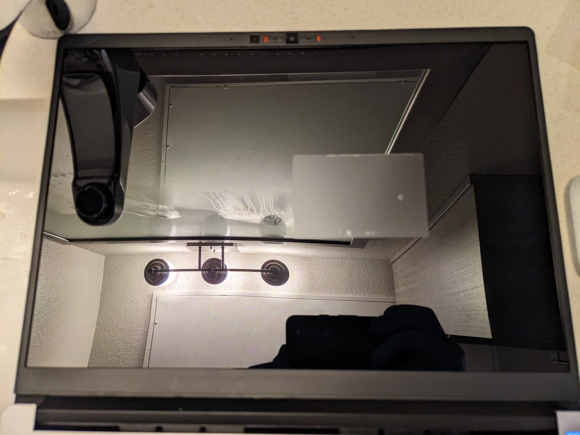

There are already fantastic photos in this thread. Here are some of mine:
Bare screen:
Full installation:
Click for more photos
These photos were taken with the screen flat down 180 degrees under my warm-yellow-ish bathroom lights. Yes, that’s a faucet in the corner
Edit: also screen’s around 25-30% brightness.
Sample:
With sample installed:
With sample with flash 1:
With sample with flash 2:
With sample closeup 1:
With sample closeup 2:
With sample closeup 3:
With sample screen off:
Full installation without bezel:
Full installation with bezel:
