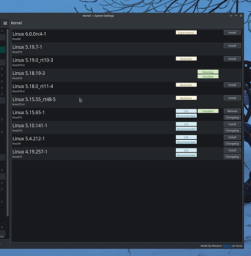

I’m having the same issue and am also on Manjaro. What kernel did you use to fix this issue? Here’s the kernels that I see available in the Manjaro Settings Manager:
Hi @Jason_Axelson, i’ve just used the next one that was not realtime (in my case 5.18.19-3, i am using Manjaro with Plasma Desktop and i asume that you are using XFCE). But that was only my first try, i did not experiment with other kernels.
Please Note: depending on which kernel you use, you may experience some stability issues. For example i have some problems with virtualbox but did’t study the issue in detail to check if the correlation is real or just me doing stuff wrong.
TLDR; there may be stability tradeoffs in switching the kernel.
One last note, in my case i have also disabled the ALS, a bit of an unorganized approach (i don’t know if there is causality/correlation), the night light is an very important feature for me :slight_smile: .
Thanks! I’ll give it a try. I’m also using Manjaro with Plasma Desktop so I’m pretty hopeful!
