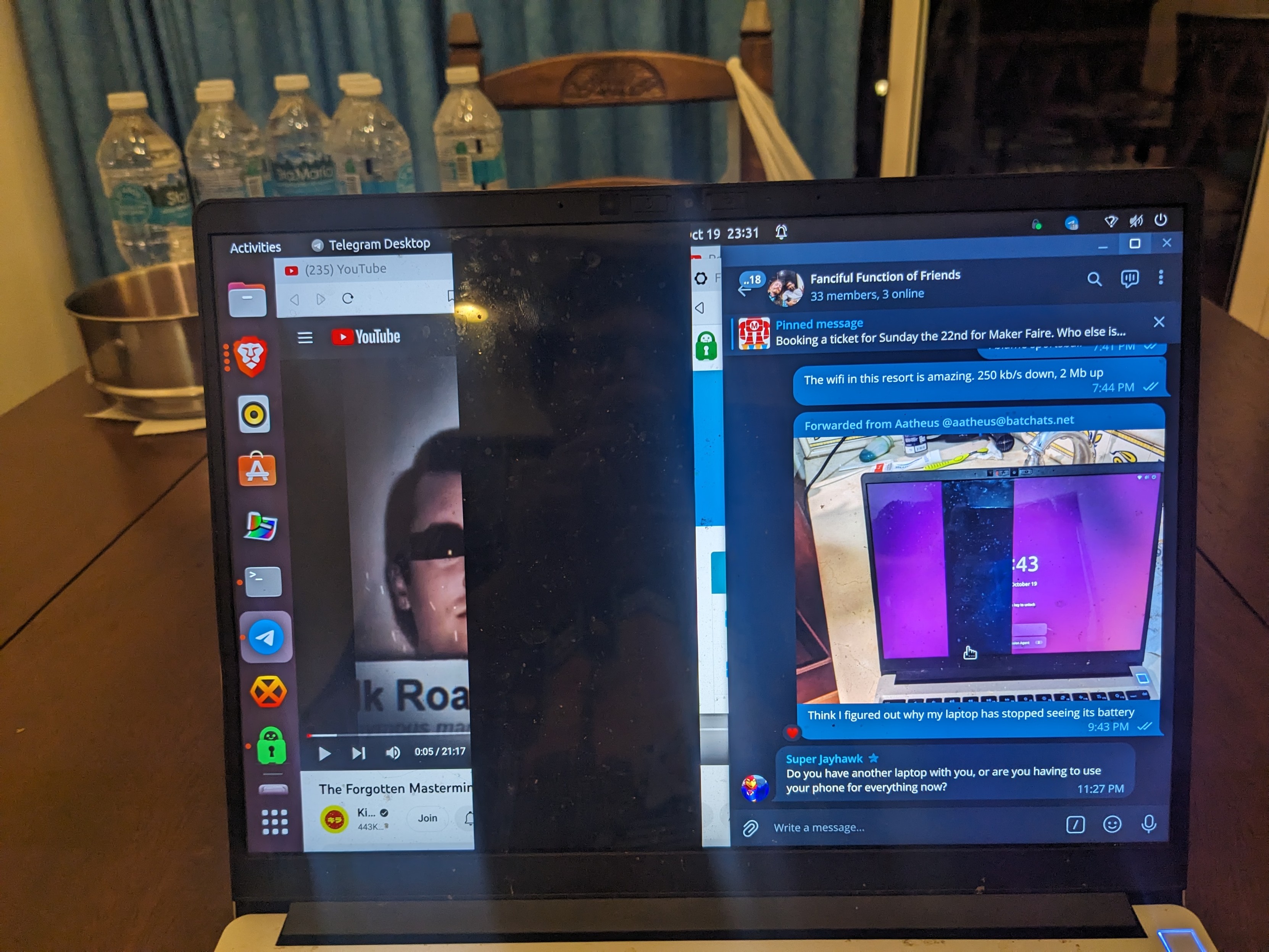

I had been experiencing weirdness with my Framework 11 laptop. One of the sets of columns had gone dead on the panel, almost like the column driver IC had failed (https://batchats.net/system/media_attachments/files/111/265/930/771/445/066/original/8449dffa13182249.jpg)

Edit: I just tried removing the new Framework 13 Original panel and replacing it with the old panel. The old panel lights up fine with video, except the dead columns are still dead. Is it possible that the panel is DoA or not compatible with my Framework 13?

Always a possibility. Maybe shipping damage? I don’t think there are compatibility issues when both panels are from Framework.
