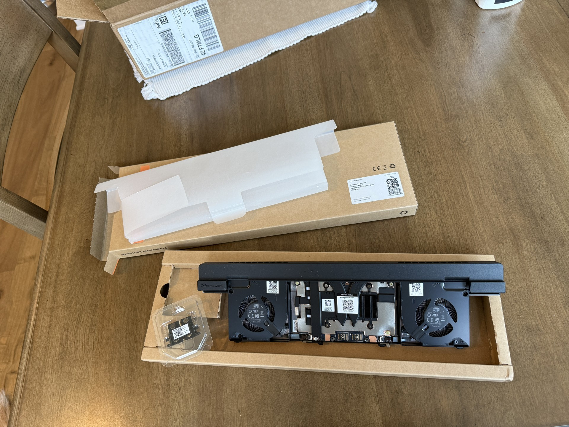

Pre-ordered the 5070 for my FW16 with the 7700S. Today my GPU was delivered and imagine my surprise when I open the box to see a 7700S in a 5070 box. This has to be a joke…. Anyone else have this happen to them or im i the only unlucky one?

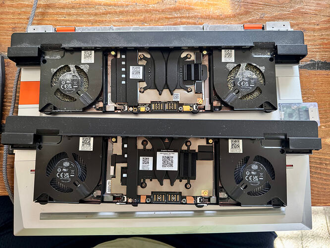

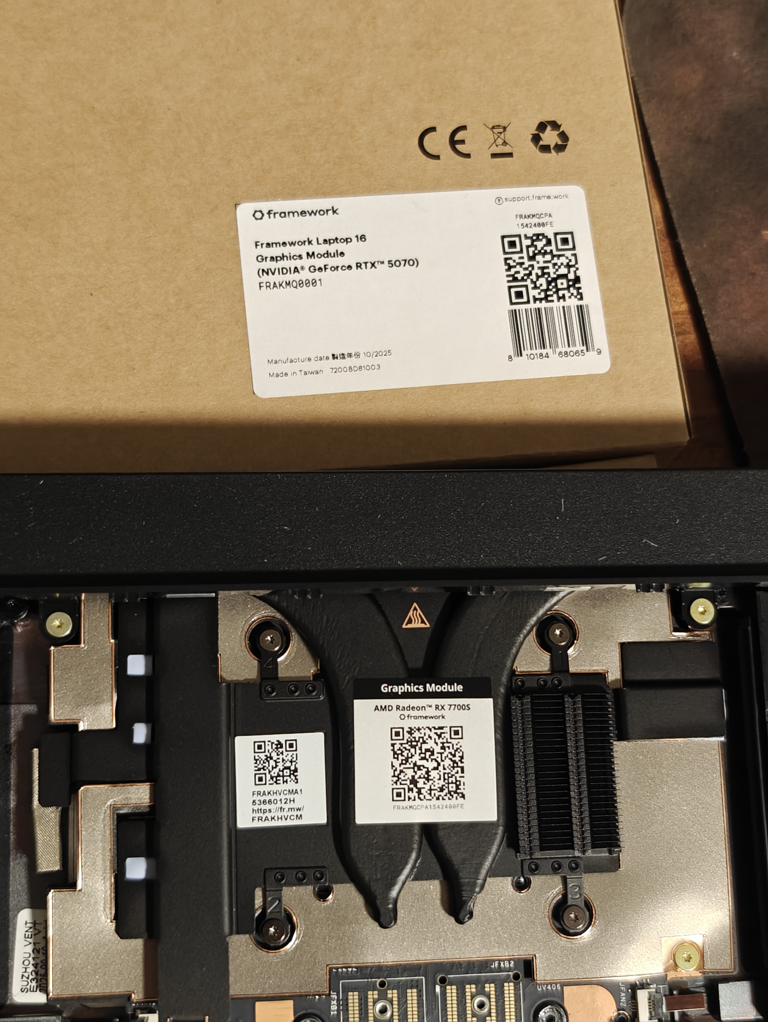

It’s mislabeled but the right GPU. There are a couple of other reports of the same thing in the forums. If you compare the black metal retainer holding the GPU board to pictures of the Radeon module, you can see what’s what.

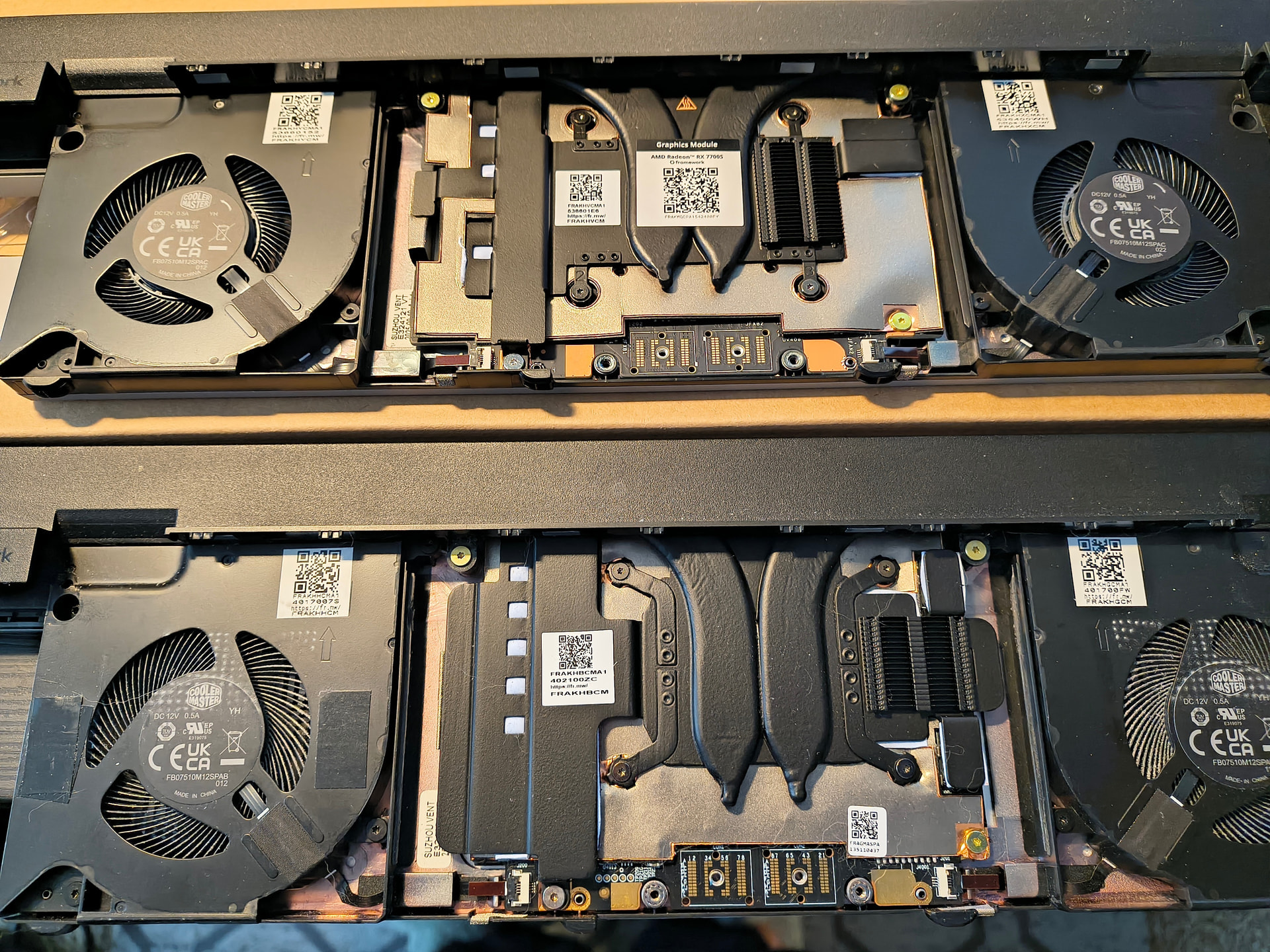

You have the right module actually. I had the same thing, they’ve used the same stickers on both modules it seem. Look at the layout of the heatsink and RAM plates, I installed mine and verified that’s a 5070 (top module in photo).

Count me as another who received a GPU with a 7700 sticker. I went ahead and swapped it in and I’m updating drivers. It just installed the NVIDIA drivers and says an NVIDIA graphics module is present. I think somebody at Framework just has a warped sense of humor.
Same! Mine was a 5070 as well. I couldn’t get the new interposer to work so i used the old one and it seems to be working fine. Man, Framework you had me going there for a bit! Thanks everyone for jumping in and helping figure this all out!

Having the same problem, here is my 5070. Almost filed a return but figured id plug it in and see if it was really an AMD card. I wonder what nvidia and jensen thinks of thousands of GPUs shipping labeled as AMD cards.

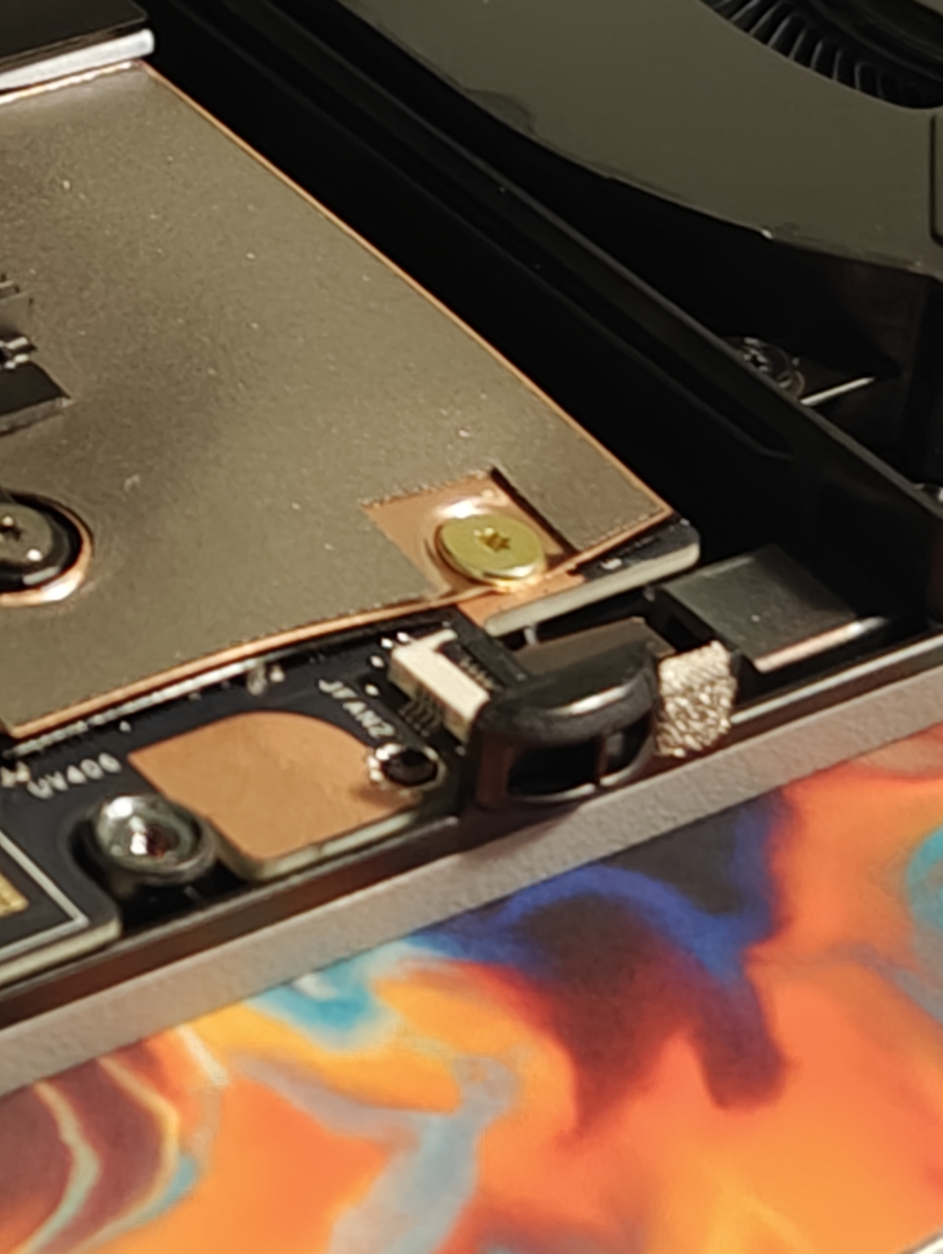

Also curious if anyone else’s looks like this with what appears to be an over tightened or misaligned screw that’s kind of bent/indented this part?
Other than that, seems to be working fine. Haven’t had a chance to game or edit videos with it yet but a quick time spy run with my 7840hs:
