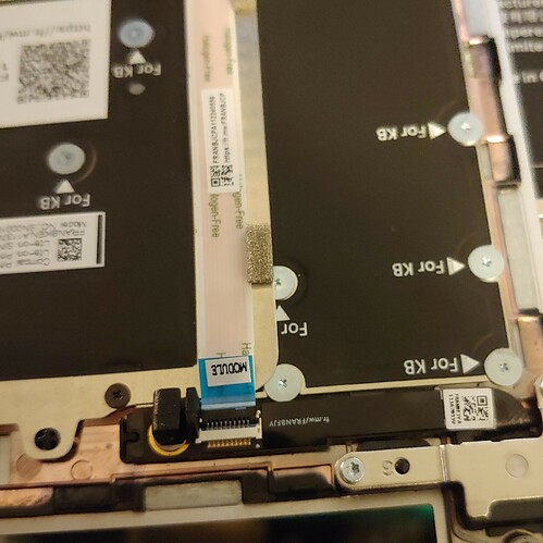

When I opened it up, I found this:
One of the rubber wifi-cable routers had managed to rip itself off the mainboard and onto the input cover. Put the router back into place and it seems to have fixed everything.
My best guess is when I opened it the first time, I pulled the cover off from the top right corner rather than the bottom right. The blue MODULE plastic bit on the ribbon might have caught the router and unseated it. Thanks so much for the tip @Chiraag_Nataraj.
