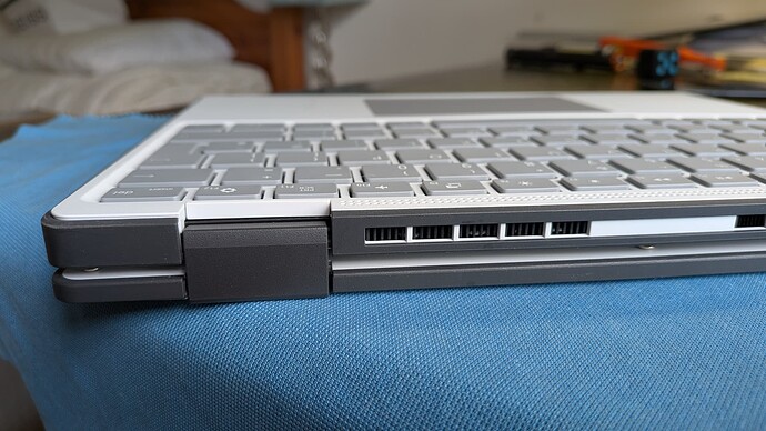

The instructions for the installation of the Input Cover says this:
“Lower the Input Cover’s top edge onto the laptop until the magnets snap it in place.
Make sure the Input Cover sits neatly within the laptop frame and no corners are popping up“.
However they are on mine:
The central bit between the two hinges in flush with the magnets engaged, as is everything else, as can be seen in the photos.
I have avoided tightening the screws below them as I don’t want anything cracking.
Has anyone else seen this?
I have raised a support ticket.
This was what mine looked like at first before I tightened the screws the first time so that might be your issue. The screws are needed to hold that part in.
If you’re really concerned about cracks it might be better to just tighten the screws without fully seating them so there’s no tension on the plastic.
OK, but that is not what happens at the two wrist rest corners… They are sitting flush with the frame, and you have to put quite a bit of force on the raised corners to get them down and into a position to engage with the screw…
So I am very hesitant to put any pressure on the plastic…
The reason the front corners don’t stick up like that is because they are held down by the plastic latches in addition to just the screws.
The back ones need the screws.
OK, I am not sure that this is correct.
Those are guides and what actually fixes it into place are the magnets that you can see in the picture - you hear them engage, and then further engage all round the frame as you lower it in.
The screws are just there to make it secure so that it can’t be knocked out accidentally.
Something is causing those corners to be raised. The part of the input cover that is between the hinges is sitting flush as well.
You may be right in that there is nothing to worry about, but I am hyper-nervous given the other cracking issues.
Support now have a whole load of photos and video, and have come back to ask for more info…
The other laptop I have behaves the exact same way.
The screws hold down the corners homie.

Although looking at my magnets, they are closer to the corners by the display than they are by the wrist wrest corners.
OK, so support have come back and said:
“After inspecting the area, we found that there are no obstacles near the top screws and that the only issue causing a gap when the input cover is placed is a few bubbles along the edge of its underside.”
So now all tight.
“bubbles” ?? :thinking:
Yeah, I’m not what support means by bubbles, unless there is a sticker or something with bubbles under it (I haven’t looked under the input cover recently). But both of my units have the corners raised up a bit like that before I tighten the screws. In fact, those back corner screws won’t even engage unless I push the cover in slightly. So whether or not it is a “problem,” I can’t say. But I can say it’s at least very common, because both of mine behave exactly like that.
I’m a bit curious if “bubbles” actually means bubbles in the plastic, which normally points to issues in the molding process looks at the on-going cracking issue
So I think that they mean the bubbles on the bottom of the Input Cover are resting on something in the inner compartment.

I have little raised input cover in front of the device in the area of the touchpad
I think there are components pushing up the sticker in the middle of at least most of those bubbles.
Your English is fantastic.
They mean the air bubbles on the bottom of the input cover. But they said it a bit weird.
a slightly clearer way to say it might be like this:
“After inspecting your photos, we found that there are no obstacles near the top screws. The only thing causing the gap are the air bubbles on the underside of the input cover.”
The way they said it is correct, just a bit wordy and hard to understand without reading it a few times.
