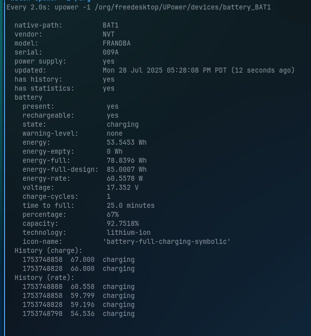

I’ve replaced the USB-C on the 180W charger that came with my Framework 16 with an Anker 240W cable because my dog ate the last one. However, when charging, upower shows I’m only pulling 60W. Is this due to the cable? Or some other factor?
Is there another recommended USB-C cable I should be using with the 180W charger?
The 60W is the energy to the battery, which is lower than the power the computer pulls from the charger
