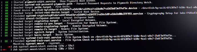

It freezes before I have any terminal or something, I will post pictures, but it’s not giving relevant info (at least not that I can see).

Meanwhile I’m uploading the boots that I took pictures.
Note, several of these look like they are still booting, (the kernel panic is obvious, others are not), but all of them I left them for more than one minute frozen before taking the picture.
The most common one is the one that goes up to “Started gdm.service” and freezes there, the kernel panic only happen once.
