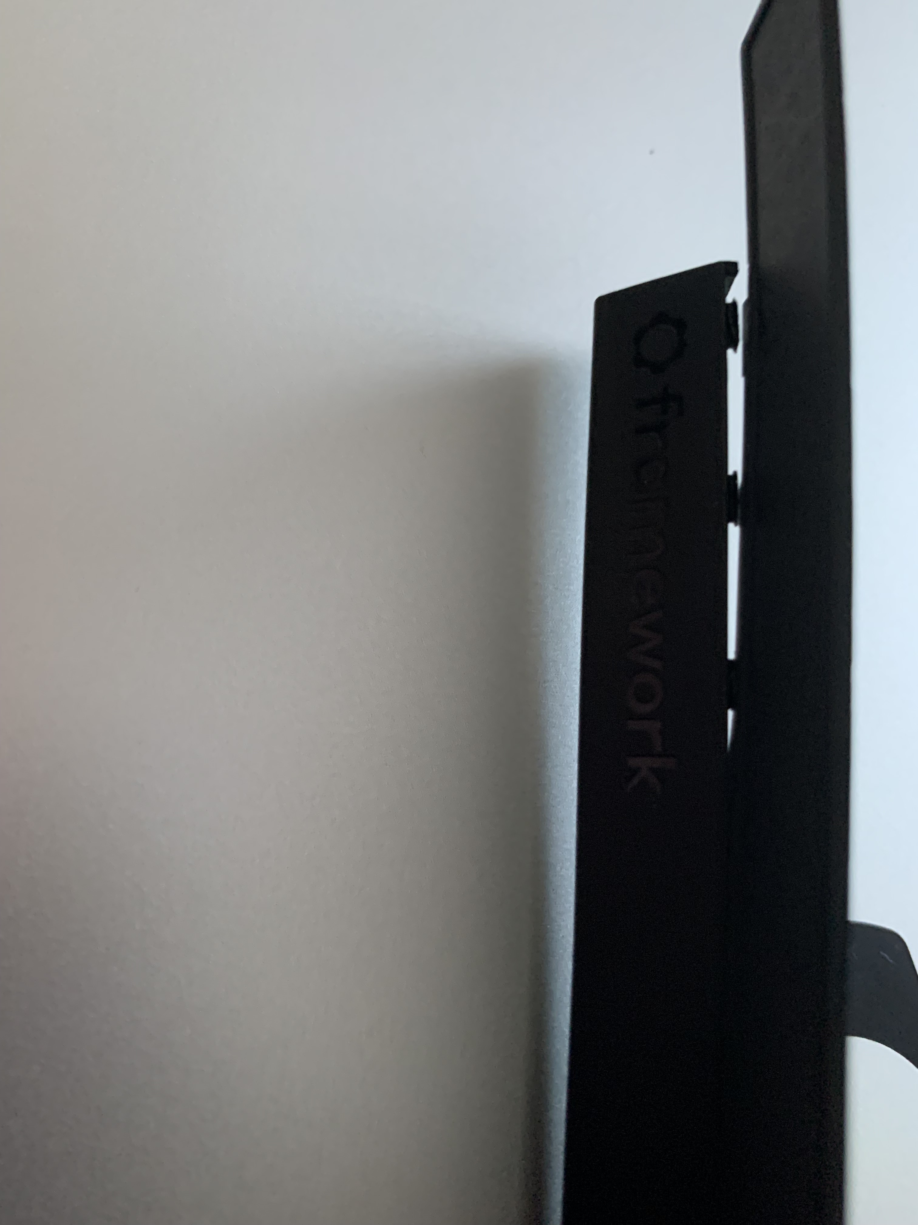

As instructed , I installed the bezel and connected the keyboard.
Closed the lid to turn it over to do the screws up and felt resistance. Opened the lid again and realised the bezel had got stuck in the bottom left corner and suffered some minor damage so I removed it. (See image).
I messaged Framework support before I continued, to enquire how to get a replacement bezel, but have not heard back from them yet ( I know they are busy).
I thought I would continue the setup without the bezel for now, but it seems as though the screen is not powering on? I get the power light on, but no indication that the screen is working, and no Caps Lock light on the keyboard.
