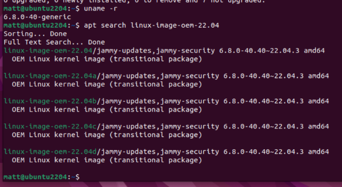

Just so everyone is clear, linux-image-oem-22.04 at this time is in fact, 6.8.0-40. You can verify this by doing an apt search linux-image-oem-22.04 and reading the output.
Now, if you are seeing a difference between the two version of the same kernel with
journalctl -b | grep thermal
This would indicate either something was corrected in the switch back and forth or there was a bug showing up. In that last instance, you will want to file a bug report as I have not been able to reproduce it here.
Absolutely nothing will come to harm booting OEM, but, you are literally booting the same thing. :wink:
The 22.04.3 attached to the kernel in the image indicate the last refresh, in this case, 6.8.0-40.
