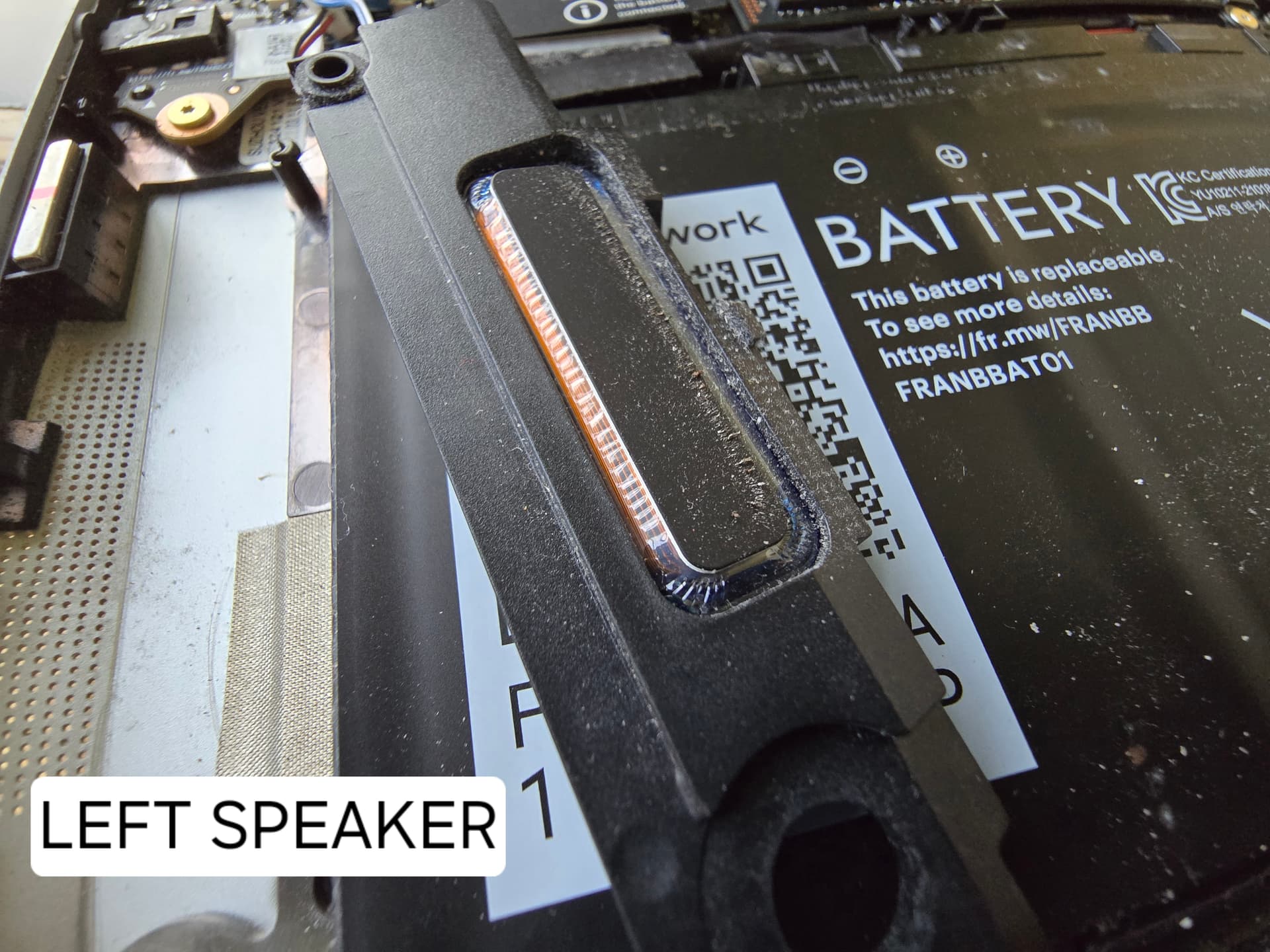

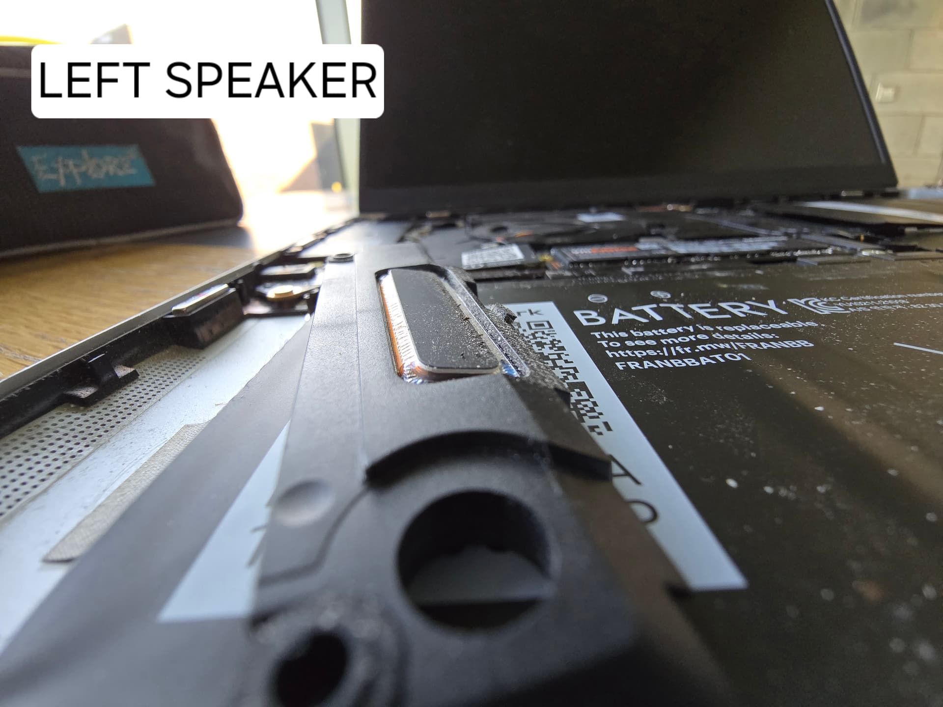

Today I was using my laptop and heard a strange and loud noise come from it (bizarre sort of popping/ripping lasting about half a second). I then noticed the bottom left corner of the palm rest become hot to the touch. It was not charging at the time (plugged in but the socket switched off) so I knew it could not have been the battery. I knew that the speaker was under there.
I took off the input cover, inspected the speakers, and the left speaker looks different to the right, the membrane looks all strained and warped. Pics attached. I left the speakers unplugged and am using the laptop normally right now.
So did my speaker just blow up???
