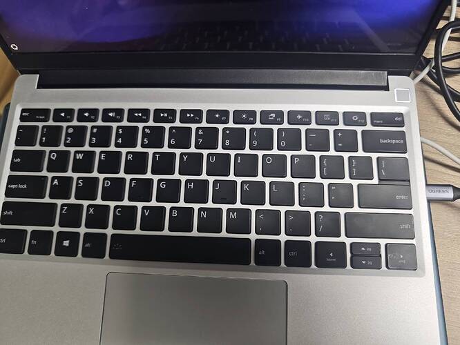

The touchpad is functioning normally, and I’ve tried the steps you suggested. However, the keyboard still doesn’t work—it might be broken. The keyboard backlight also appears to be gone, as you can see in my picture.
Looks like the finger print reader light is also working. Contact support, they should give you a replacement input panel.
As a quick note, the 2nd gen finger print sensor is amazing, I get no misreads. I don’t think they are replacing 1st gen with 2nd gen, but it could be worth asking.
My guess is the board that’s attached to both the backlight and keyboard has a broken part. I thought the two parts were separate though.
