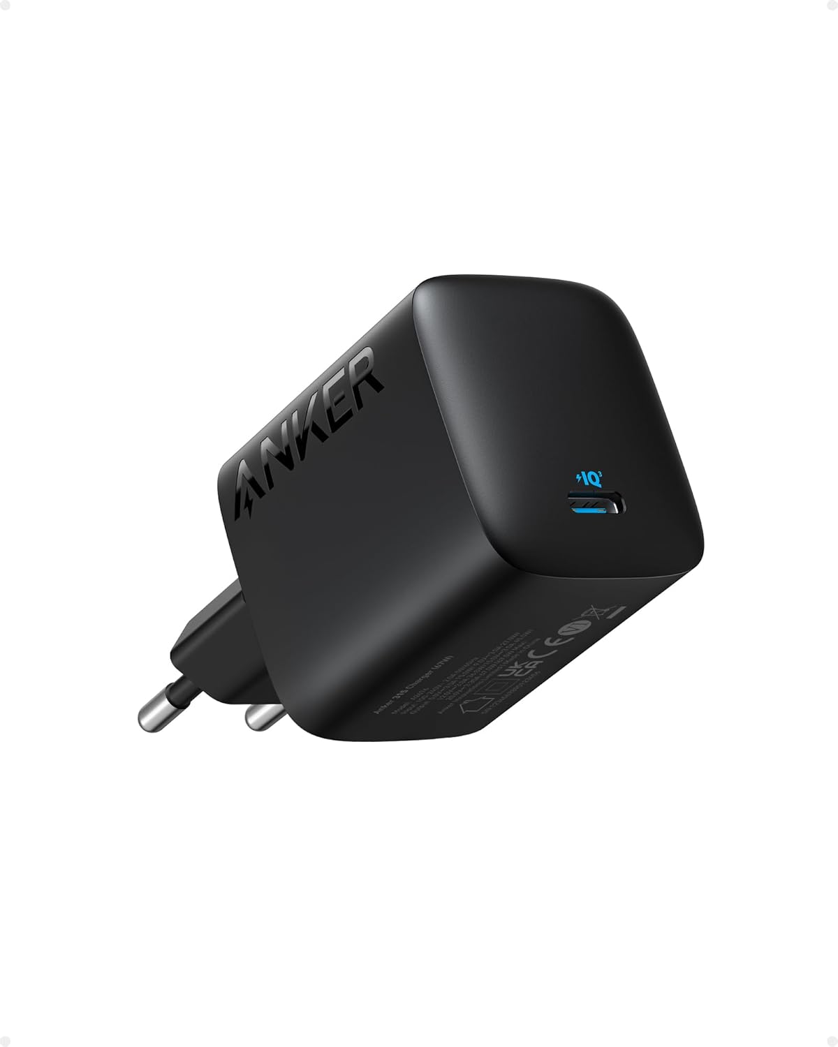

I am using the following power supply x2 for the Framework Laptop 13 and Thinkpad X1 Carbon, and the power supplies have been no problem. I continue to use the power supply for Laptop 12.
67W USB-C Charger, Anker 315

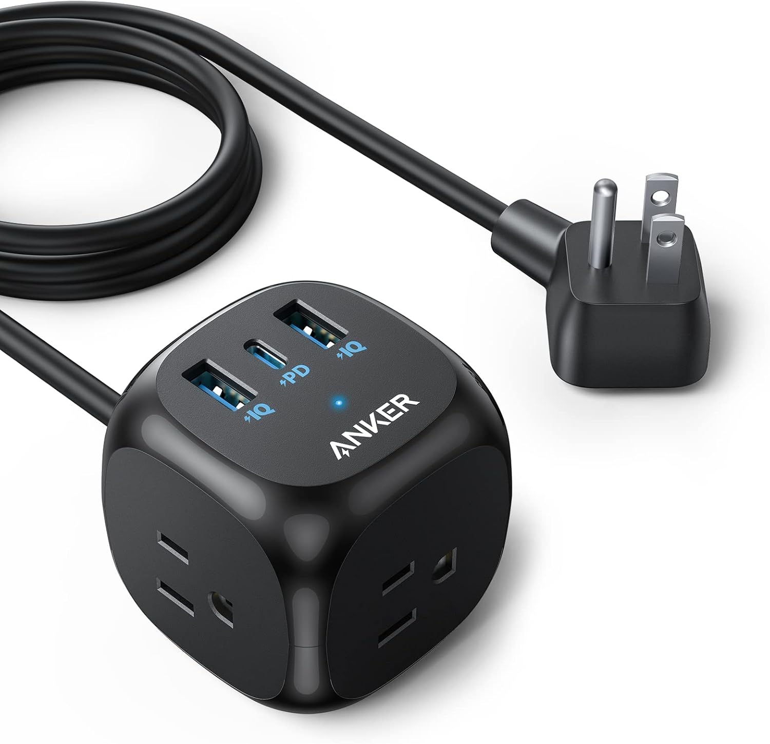

For me, that, and frequently terrible outlet placement, why my carry-on has this one of these along with a stash of USB cables and my travel router. I won’t be trying to charge my laptop on the USB ports, but they’re plenty for a wireless phone charger or small power banks.
