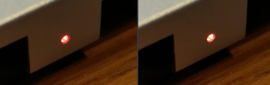

Sadly I’m now in the camp of does not boot (7640U). My LED sequence is 12 green and then GGBBBBGG for the POST code, display backlight comes on for very short burst and occasionally the fan does too. My RAM is the KSM56T46BS8KM-16HA (5600MT, CL46). Not directly on the KB ram article, but KSM48T40BS8KM-16HM is, which is the 4800MT CL40 model. Only hardware difference according to Kingstons Memory part number is A-die for mine versus M-die for the ones in the knowledge base. Number of chips, PMIC, SPD Hub, Thermal sensor, everything is the same. I tried disconnecting the main battery for a few minutes to prevent an earlier DRAM training during testing interfering, but no dice :confused:
Edit1: After some tinkering the POST code changed to GRBGGBBBBB. Curiously 2 more blinks this time…
Edit2: Thanks to @Jonathan_Haas identified the sequence to actually be
indicating a RAM problem.
That would equate to “everything ok, entering Sysprep mode” (which I believe is a mode the the manufacturer flashes the base system image). This looks mostly ok, maybe it’s not detecting the SSD or the system installed on it.
That sounds weird, after the orange color there should be only 8 blinks. Are you sure you didn’t mix up red and orange? When it really was GGGGGGGGGGRG O BGGBBBBB, that would indeed indicate a RAM failure. But maybe you just made it worse by “tinkering” with it?
You are probably correct. I stepped through a video of the sequence and the second reddish one seems to be orange:
But it is very close, maybe another color would be nice :slight_smile: Tinkering means switching the modules around, trying each one in different channels etc. Sysprep POST was actually my first try, will try that again, only one module in channel 0. My SSD is empty, but I did not get the framework cog on display or any other output.
I have now seen GGGGGGGGGGGG O BGGBBBBB and GGGGGGGGGGGG O GGBBBBGG while trying all possible combinations of slots and my two sticks of RAM. Display stays black but with active backlight. Roundabout a minute between pressing the power button and POST code blinking.
