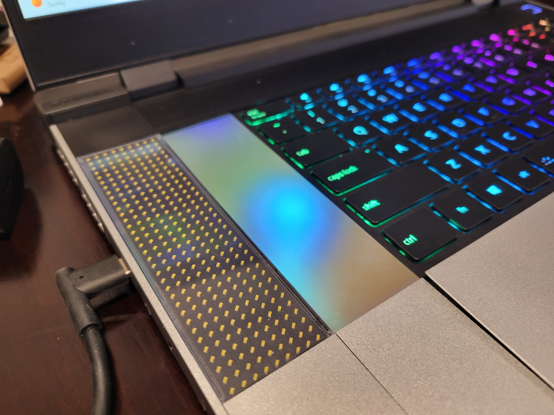

In particular, the touchpad piece seems to not fit very nicely, sticking up a little bit as shown in these photos. HOWEVER, in these photos everything is working. If I try to do some positional adjustments some combination of the following occurs:

Could you take additional pictures?
The touchpad looks like its side edge is sticking up a lot. Is it’s the front edge hooked under correctly?

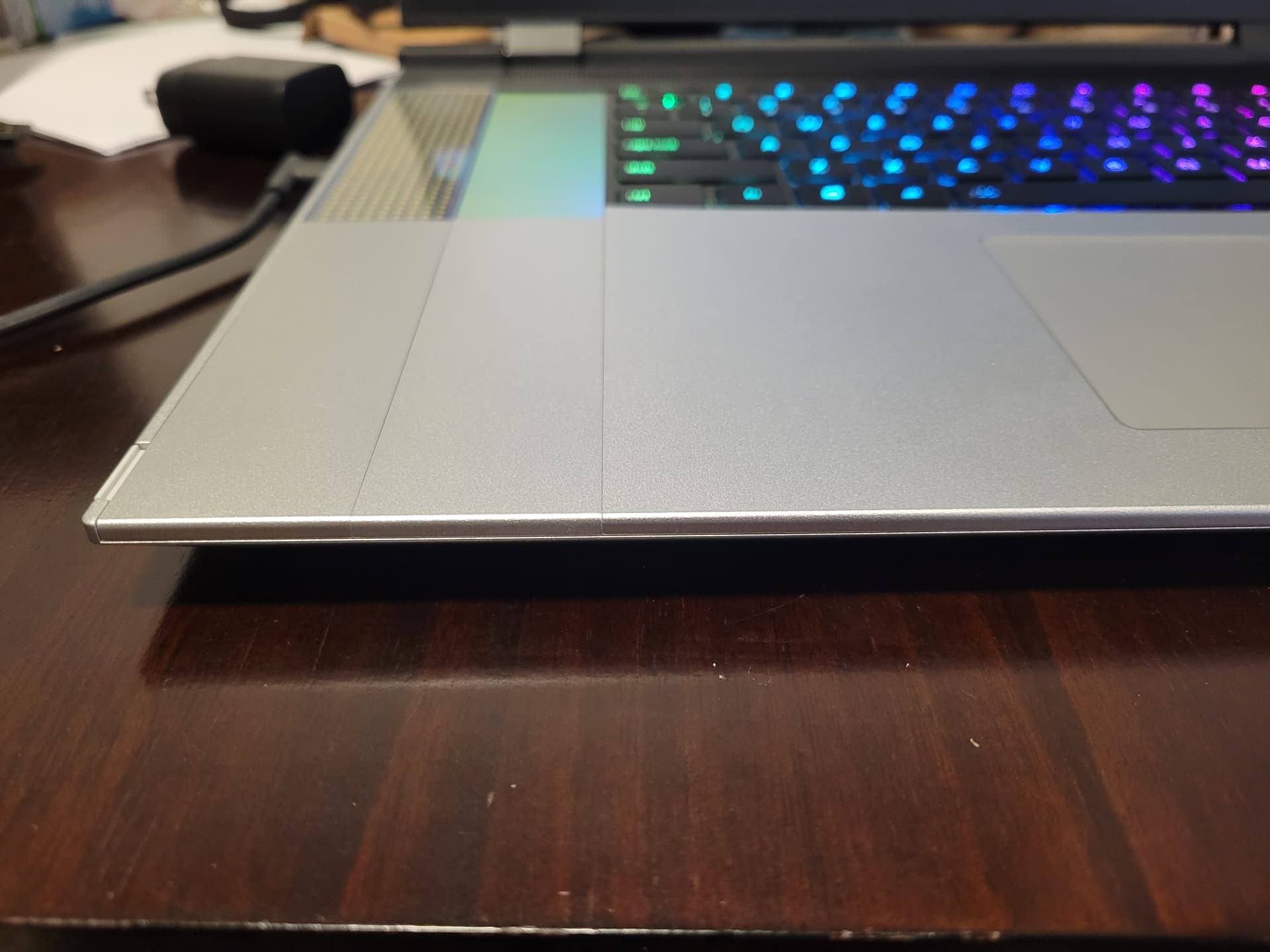

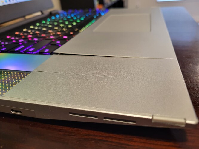

This is my current setup that has all pieces working. Can provide more photos as needed. I am sadly a new user so i can only embed two images at a time.
Im a bit hesitant to make adjustments right now since it is all working, but my own observation is that the spacers and keyboard are flush. The right and bottom of the touch pad seem flush as well. Im beginning to wonder if perhaps the shape of the touch pad is the problem and perhaps the earlier keyboard problems were a symptom of mispositioning.

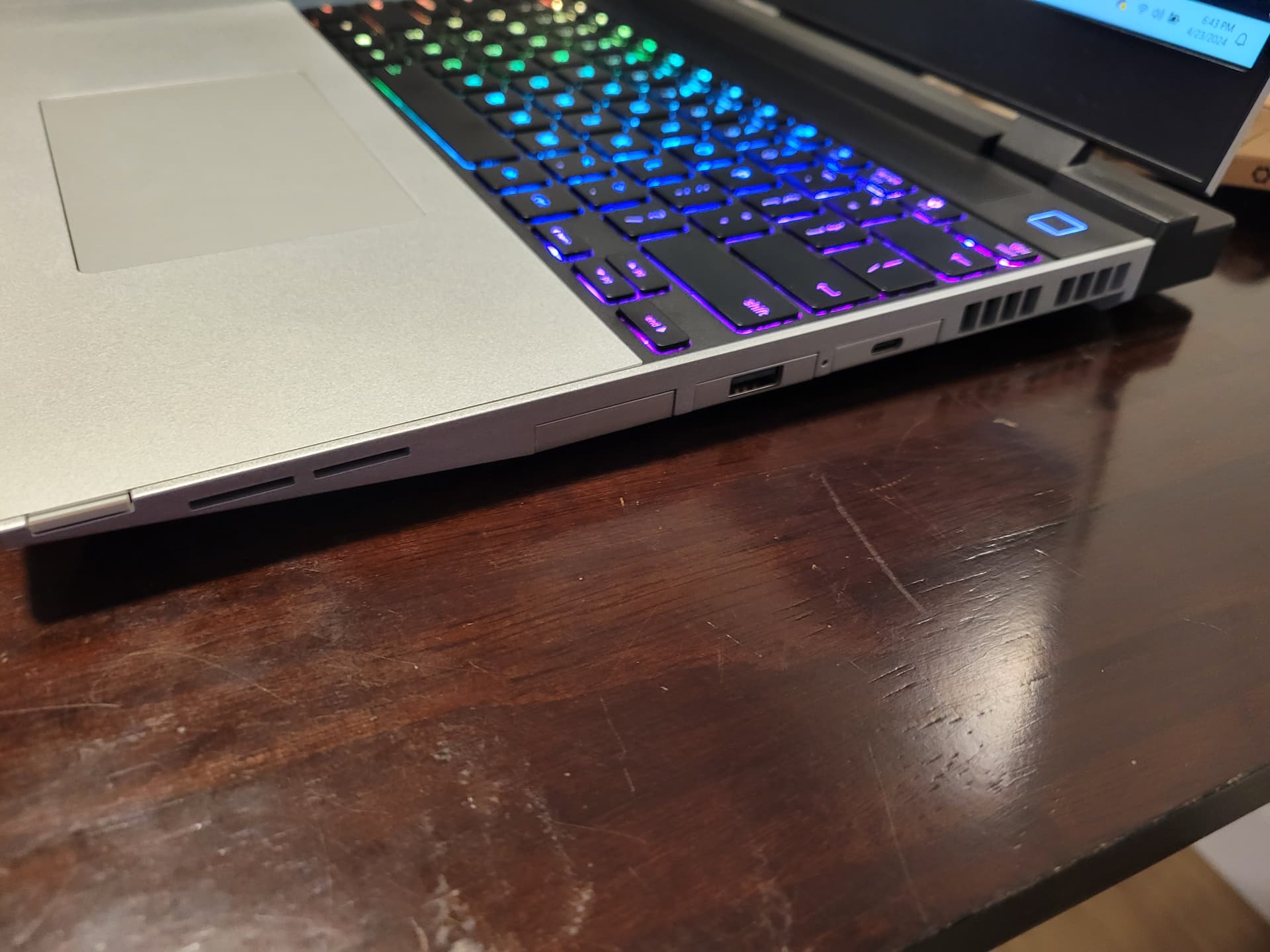

Two more.

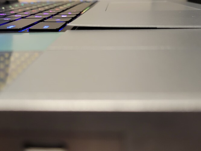

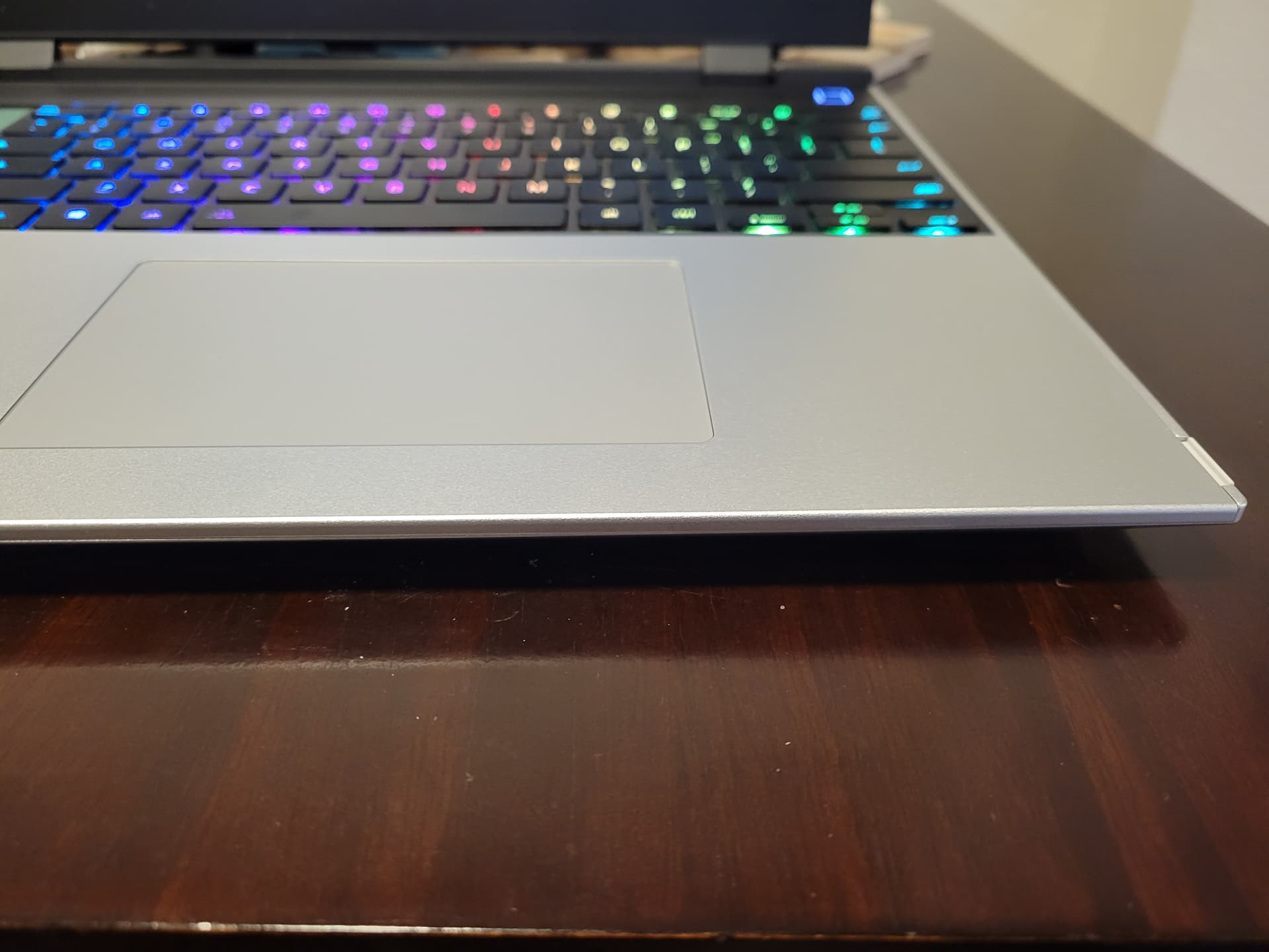

Last ones
Notably the corner seems to…bend upward?
Oh yeah, that’s certainly not right.
Not sure if it’s related to your connection problems.
Appreciate the input, it’s always good to get a second opinion even when reality is staring you in the face haha. I’m suspecting that it might be related; it could be that earlier when I hadn’t noticed the touch pad deformity I was positioning my pieces incorrectly or something. :sweat_smile:
