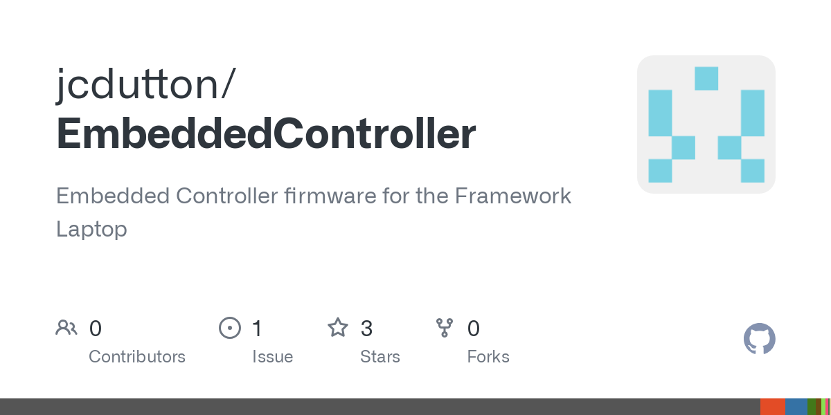

@James3’s fixed ec may help here, sounds like the whole wrong charge controller state thing.
Not sure what you’re referring to. Can you provide more info and/or a link?
It’s somewhere in this monstrosity of a thread.
Here’s the guide but probably a bad idea to just send it without context.
