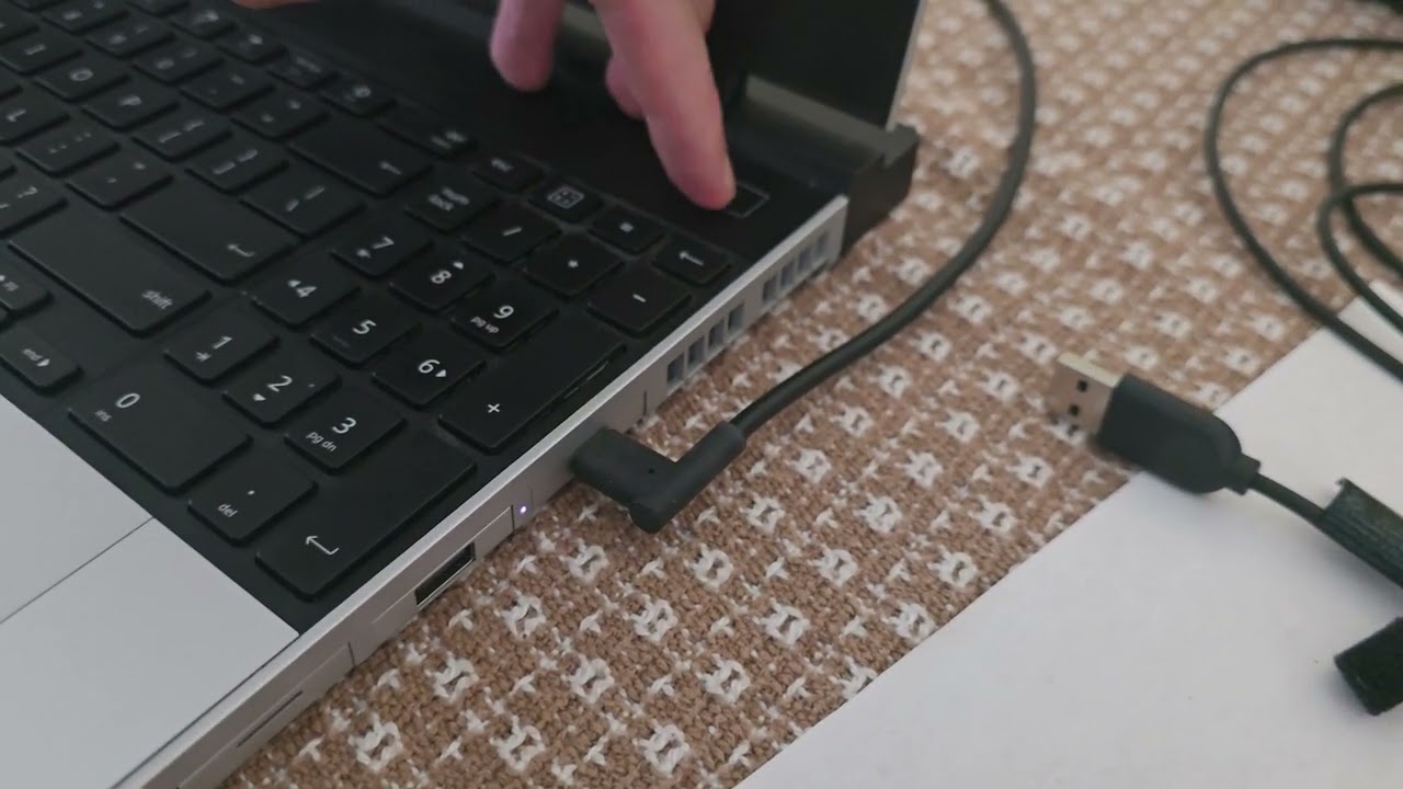

But pressing the button gives no response. Either on the top power button or on the white led on the side where I have the charger plugged in.
Here is also a video of what it was doing. This was after I started working on it to try and fix the problem. I normally have the machine propped up off the table.

It did not have any blink codes and just stayed lit white with it plugged in indicting fully charged.
Sometimes pressing and holding it will do either a quick blink once red or a quick blink once blue but that is rare and not every time I press the button to turn it on.
If I have the top panel open and press the power button it blinks once red and then once blue and goes back to white.
90% of the time though it just stays white led on the side and the one on the top does not lite up at all like in the video posted above.
Those last few steps also did not help and does the same thing where it just stays white when I press the power button.
