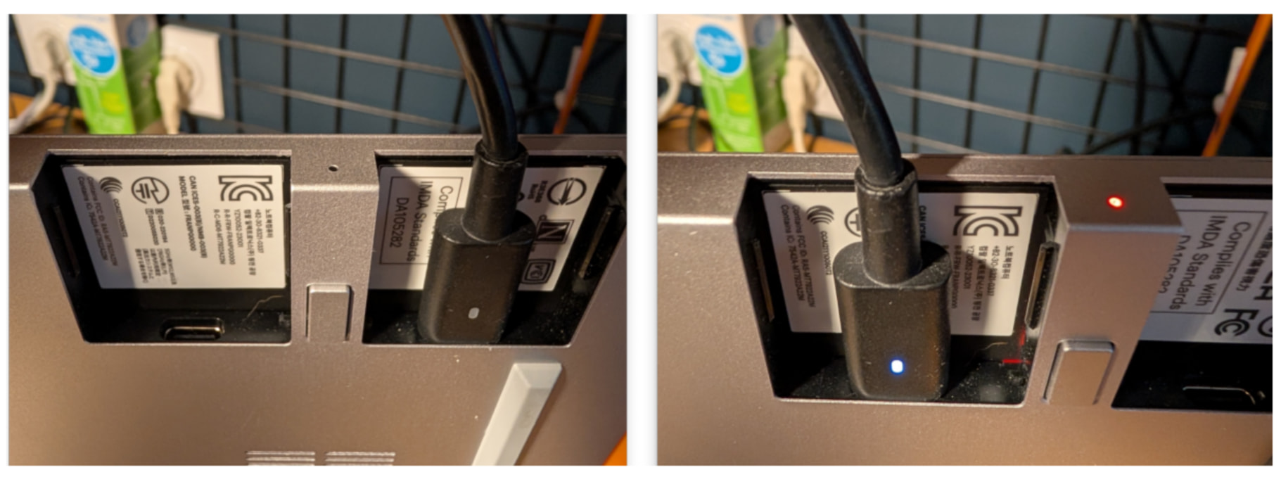

For a week I realized that port #3 (# reference according to Expansion Card Functionality on Framework Laptop 13 (AMD Ryzen™ 7040 Series)) doesn’t work any more / if I plug a charger it doesn’t charge, if I plug a screen it doesn’t light up.
It is not related to expansion card.
Here is a small picture explaining the problem. When plugging a charger.
Left is port #3, right is port #4.
When plugged in port#4 it is the expected behaviour, leds are on, and laptop is charging. In port #3 even the charger led is off (I don’t know what it means, it doesnt feel right, this is a Dell XPS charger)
(port#3 on left, port #4 on right)

The Dell charger (I use a similar one) likely turns off because that port is short-circuited or something like that.
Definitely talk to support. You will probably need a mainboard replacement.
Jonathan is correct either there is hardware damage to the port and it is inoperable or the EC recognized something was wrong with the port and disabled it so it did not cause further damage to the rest of the components.
Talk with support. They are the best resources when it comes to diagnosing what is wrong.
It is possible that the port has been disabled by the EC and resetting the mainboard and disconnecting/reconnecting the battery may reinitialize the EC to test all the ports for functionality.
Thankfully there are three other ports that presumably are still working as intended. Shorts and malfunctions happen all the time. More so in the wintertime with static shocks not playing nice with electronics.
If the port was just disabled, the dell charger wouldn’t “see it” and continue to light up the LED (as it does when nothing is connected).
Is the Dell charger PD compliant? If so it should output zero voltage when not connected to anything, hence no LED light
I believe USB power supplies (PD or not) usually output 5V by default regardless of if they’re connected to anything. In any case, my dell charger definitely lights up if not connected to anything.
I guess my knowledge is a bit outdated. So in this case, the Dell charger originally has 5V output, when plugged to the good port it then negotiated 20V, while on the bad port it shut itself down. Short circuit is a possible cause
yes the same for me. It has always been lights up. Very first time I have this case with a usb port.
I am in contact with support team.
We tried a mainboard reset. It had no effect.
We tried to use a different linux distribution (fedora), no effect (I don’t see how it could be related to installed distribution because it happens even when laptop is powered off)
Will update you if something positive happens.
Pure usb-c should not do that. Usb-a to usb-c does that. C to c needs some pd to even get 5V (but that can be only basic resistor pd).
I guess chargers with built in cables are kind of wild west and dell will do whatever it wants anyway.
it seems mainboard is defective and has to be changed.
