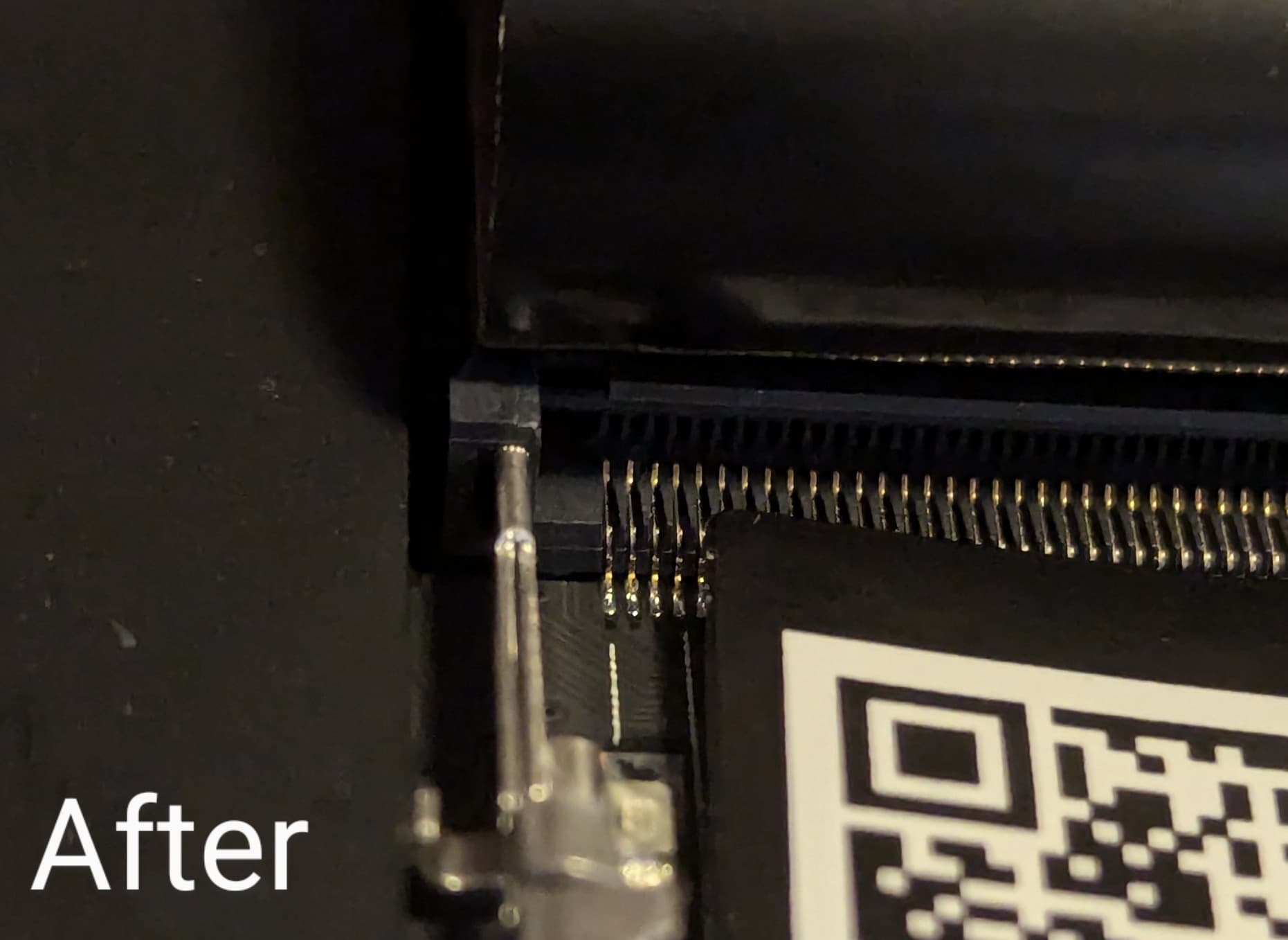

Appears my issue is due to some bad pins on the slot 0 SODIMM socket. Got into contact with support and was taking pictures when I noticed pins 4 and 8 were recessed further than the others. Tried booting with memory only installed in slot 1 and got the system to post. Verified both modules work just to be sure.
I’m not sure when the pins got damaged but did noticed that the sticker identifying the slot was not attached to the board when I received it. Should have probably inspected the pins then.
Little annoyed to because I tested with one module only but only tested in slot 0 apparently.

Confirmed. I have a bent pin too @spdrpig. DIMM slot 0.
Update 2:
Well I didn’t think that was going to work, but I was able to gently move the pin back into the guide. It wasn’t pretty but apparently it made contact and boots now! For any who would attempt to do this: I recommend you contact support to see about replacing it first and if they care if you try repairing it yourself.

Just sharing that I got exactly the same issue when setting up the Ryzen 7040, the screen was black after the first boot.
I checked the pin and it was bent! Maybe I installed the RAM badly? So I gently put it back:
And it worked perfectly :smile:
Thanks for sharing this issue, I would not have looked at it otherwise.
That’s some fine work you did. How did you go about it? Any particular size of tweezers or something?
All three incidents seem to have bent pins to the left of the slot. Is this a pattern and no longer isolated issues?
Haha thanks, I pushed it with a sharp knife because that’s very tiny! I initially started with a tooth pick but it was too big
Nice. Looking at the before and after photos, am I correct to assume the pin was just ‘flexed’ out of place…but it’s not permanently bent? And that you gave it a bit of a guided push, and it was able to get back into the intended / designed position without further intervention?
@Destroya
I think I might know what’s going on here:
Potentially, the RAM stick(s) used at the factory for DIY factory test is having a worn out contacts (because the RAM stick has been inserted and removed so many times). The contact is no longer smooth on RAM removal…and catching the pin ON THE WAY OUT. That’s why the boards are passing the tests…but failed at customers end.
This, IMO, is likely why the bent pins are appearing on the left side…a cluster scenario. (Consumer-grade RAM module suffering from tooling-level wear and tear)
Yes just a guided push until it’s straight
