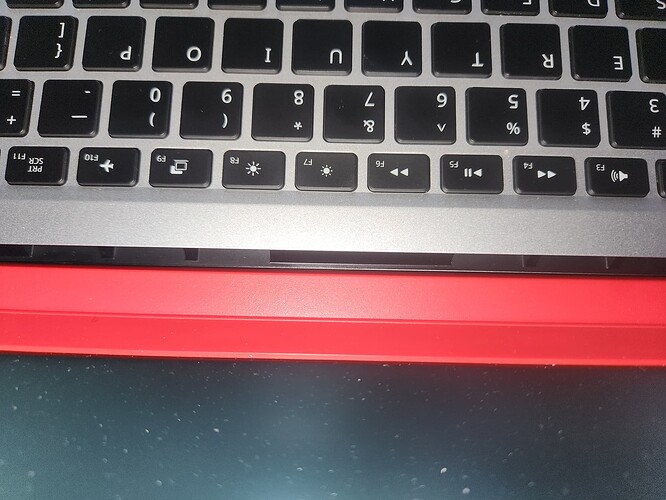

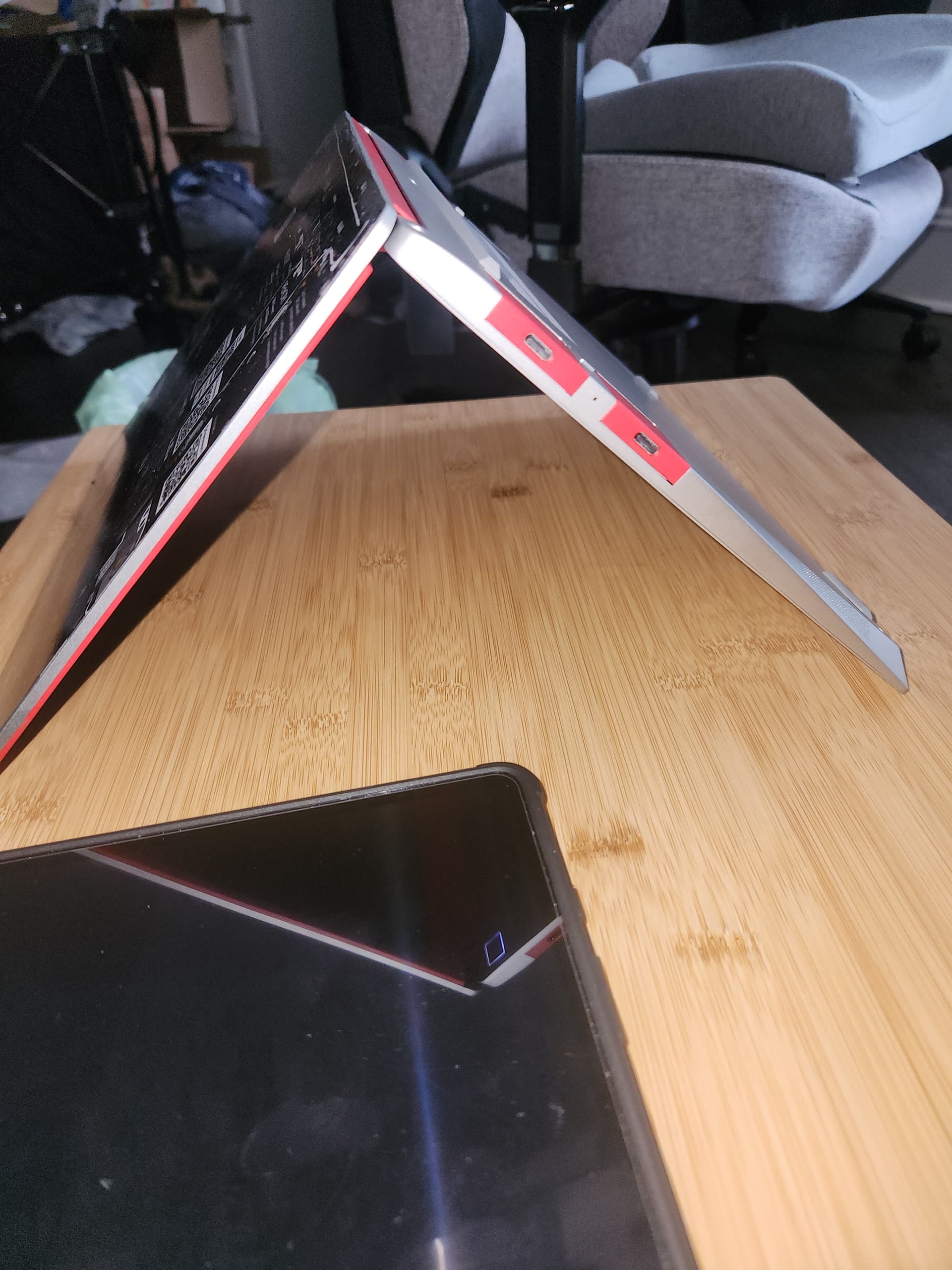

When docked, do you have the lid closed too? The intake fan is UNDER the computer to draw in air and then it EXHAUSTS heat in the gap between the monitor and the function keys at the top. Excessive heat = battery go boom.
This is the exhaust by the screen hinge.
You cannot simply keep the laptop closed and run it - even if you have a fan blowing underneath it. The heat has no where to dissipate.
But this is all only true if you have your lid closed. Also makes me wonder if you needed a fan while running your dock if the lid was open if it was thermal related.
That linear exhaust flow only looks correct because the bezel is off. Get your own fw13 out and you’ll notice it’s 100% meant to exhaust with lid open only because hot air rises.
Vs

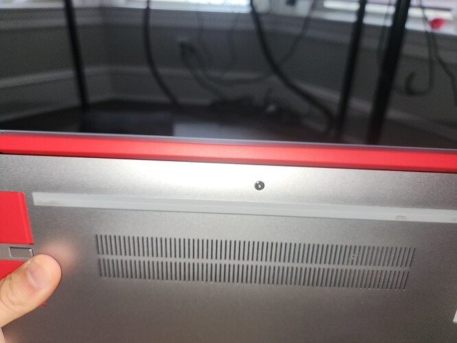

The bezel completely occludes the linear idea of an exhaust vent. So where would it go if it’s closed off? Let’s look at the bottom.
But again: hot air rises

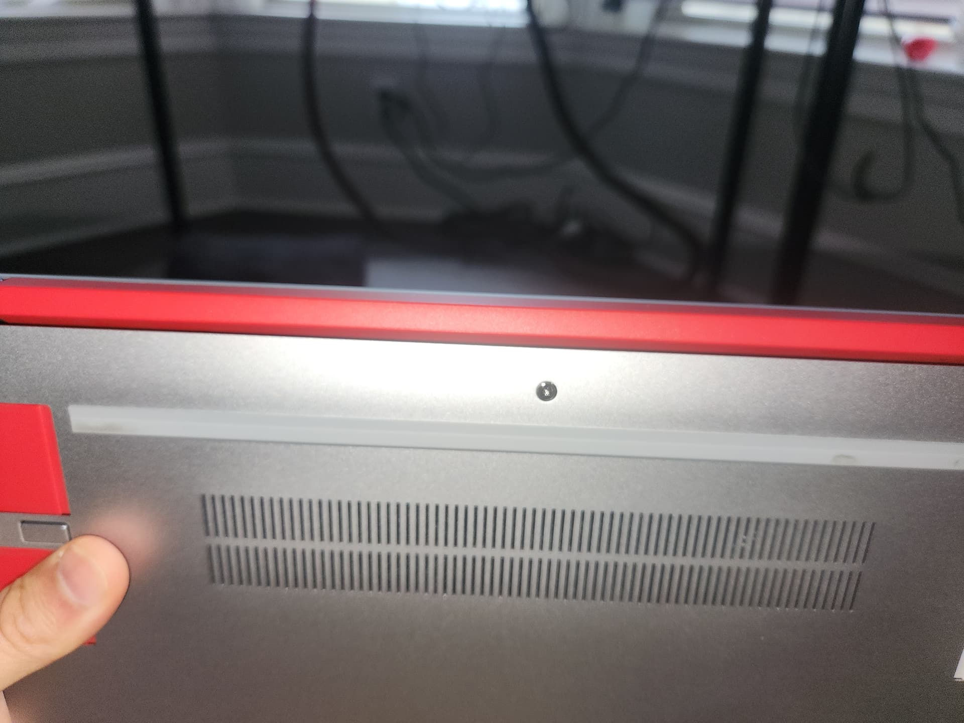

So let’s compare the actual flow when you combine hot air rises with the lid open and the angle created for flow via screen lid open:
This is the angle seen at a typical 90 degree hinge.

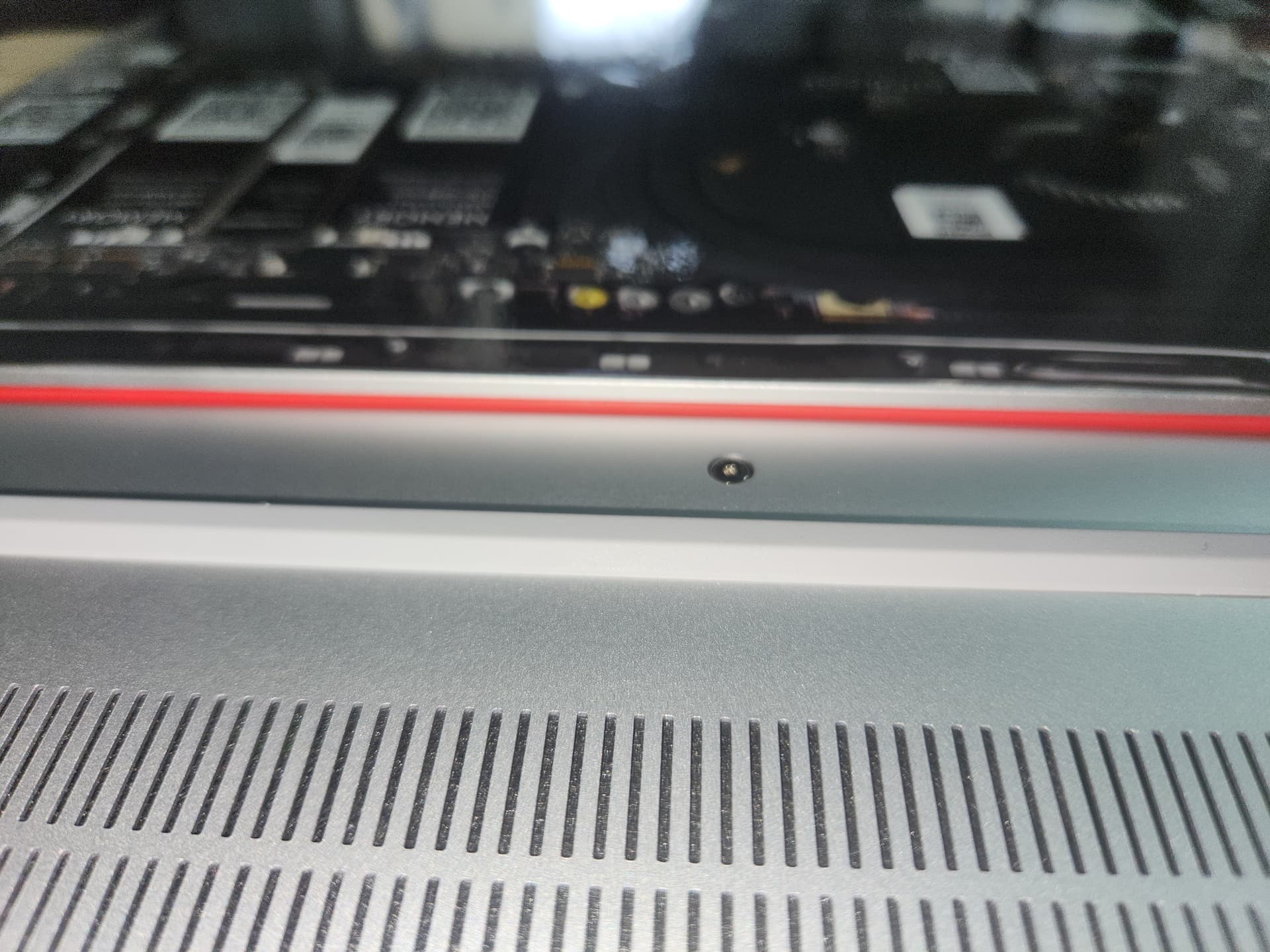

You’ll notice that as the lid opens up more and more, the bottom angle closes up more and more leading to a upwards angular flow. Let me prove it to you with the last photo using full open hinge.
At full open hinge, there’s 0.0001% of air to dissipate downwards.

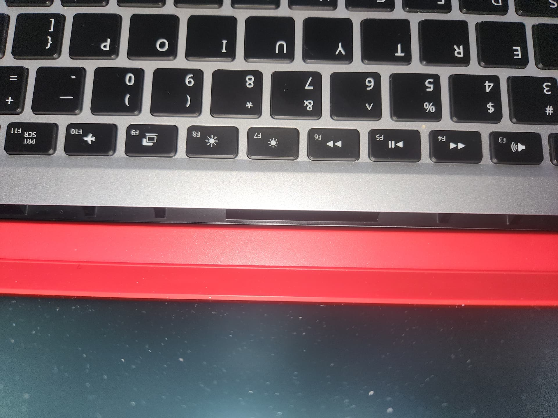

In my last photo, if you look at your own fw13, you’ll notice in the keyboard gap per my original photo:
There are even angular upwards facing vents with a bottom occlusive ramp between the screen itself and the bezel combined.
Hot air rises.
This laptop reminds me of the chromebopk pixel 2013 because of this engineering. Super cool but definitely not dockable closed.

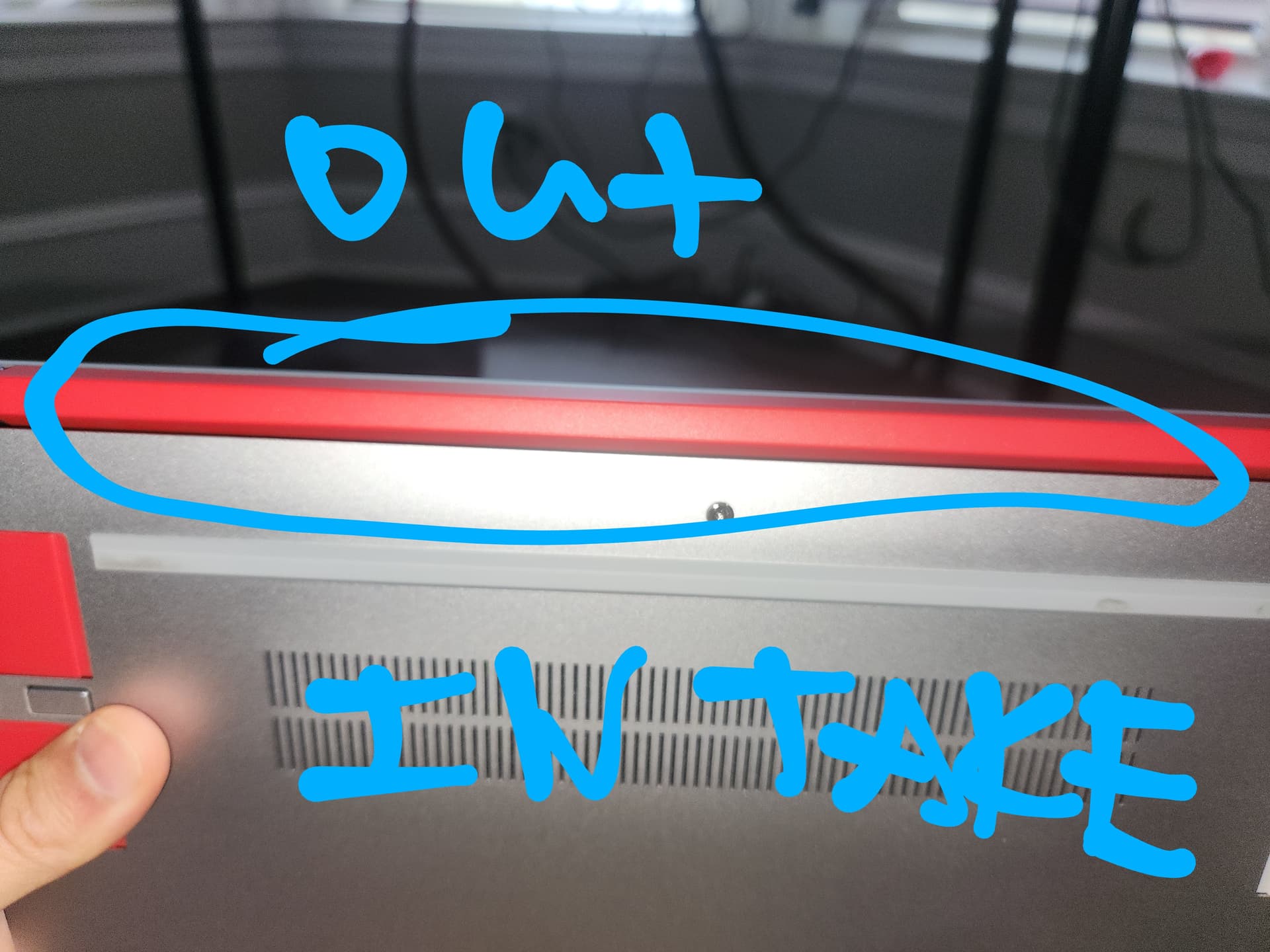

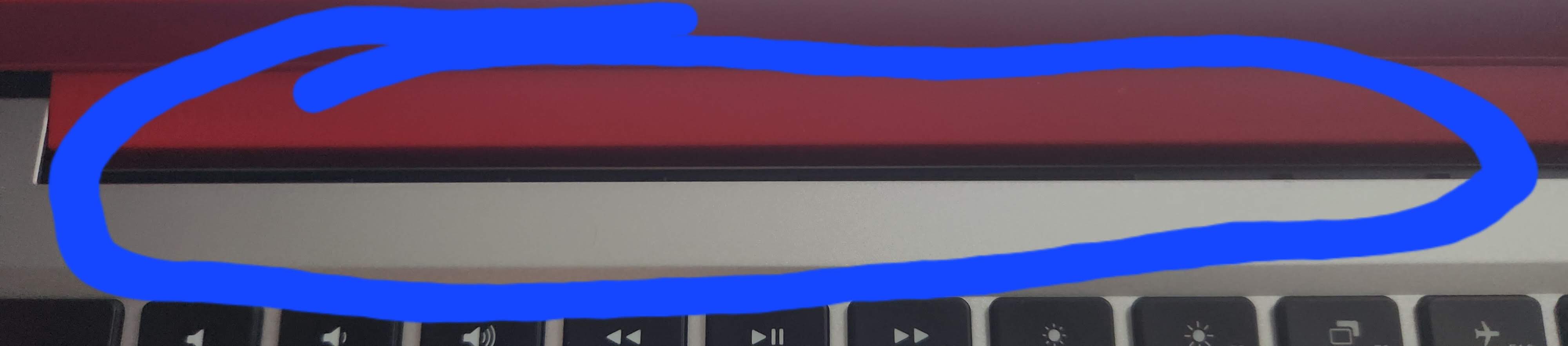

Edit img for clarity:
I am not referring to the back slits as the fan exhaust.
