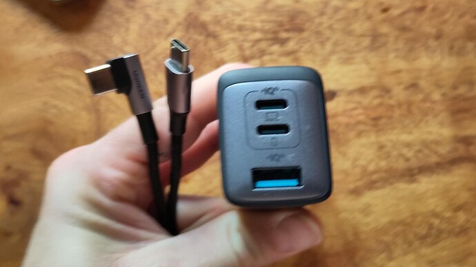

It started with my 14 month Ugreen Gan adaptative mini power 65W charger that I used without a problem with thinkpad E590.
It started to unconnect then reconnect, which is normal behaviour when you plug two device to the multi USB power supply.
Also it does it One time , I guess to adapt the power but then it does it in a LOOP every 2 seconds it disconnect and connect power !
So I ordered an Anker power supply and it does the same thing after wakeup from sleep when I open the lead of my laptop.
It goes away with the anker when I disconnect physically the cable and reconnect, so easy workaround! But I am concerned it might end like the Ugree not working anymore

    => I am using USB C to USB C ugreen 60W cable (I have another white 30W for phone that I never use with the FW) directely plugged to the Computer icone power output:

After 3 monthes I believe I found it.
It seems it is the 2m Ugree, cable that is somehow not recognized by framework.
I have used for 2 days a 1M cable that was shipped with my Pixel 4A, that shouldn t work by the way since it is not rated 60W… BUt the issue for now disapeared!
I will confirme later on this forum if it confirmes to work.
THe thing is now I have to be at 1M from a power plug :frowning:
SOLVED
It was the Ugreen 2m cable that was dying on me progressively after only 17 months.
It began to fail even charging my phone.
Now on a 1m cable nor problem.
