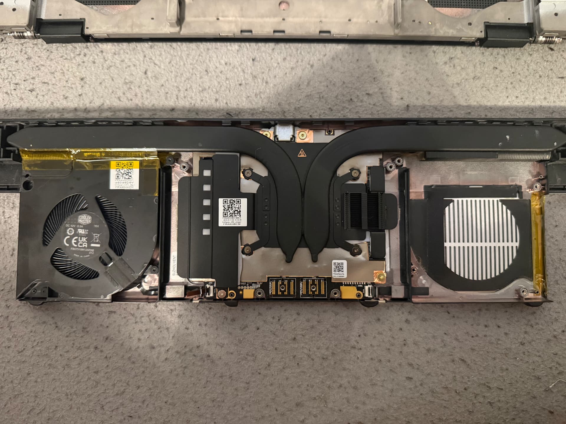

however, the 2nd gen graphics shell has “an updated mylar over the vent hole to support the 2nd Gen Graphics Module Fans”, according to its marketplace page.
this means the 2nd gen fans are supposedly not compatible with a 1st gen gpu. but what makes them incompatible, and what would happen we’re one to install 2nd gen fans in a 1st gen graphics module? inversely, what if someone put 1st gen fans in a 2nd gen module? (well, since the new fans and modules haven’t released yet, i guess we’ll just have to wait until someone tries it by themself once they’re out)
Check this post out, it outlines the changes in the shell nicely. IMO, nothing you can’t mod yourself, and also hardly an “incompatibility”.
If the vent hole mylar is the only change they feel is significant enough to mention, looks like you could convert a gen 1 with scissors or an exacto knife.
As my Post is already referenced. I already did mod it. And yes it changes the pitch somewhat. The high pitch is a little less, but I don’t fully trust my subjective Opinion on how much. I would love some more People to test it.
The Gen 2 Fans should also fit as the whole undercarriage is the same.
Each GPU replacement part is backward compatible on its own. It doesn’t sound like they depend on each other.
I was not saying anything else. I was just showing there is no need to buy the whole frame in new once the parts are avialable.
I also tried out the mod: the high frequency components have decreased. In addition to the unavoidable humming noise, there is still a noise at a higher frequency, but it is less distracting. The noise is barely noticeable through the exhaust vents; it can only be heard clearly through the air intakes above the keyboard. Listeners around the Laptop 16 with 7700s are much happier.
What I did: I taped up the area under the fans up to the 4th milled groove (from the inside) and taped up the holes (where the ribbon cable for the fans changes from top to bottom). In addition, as with your mod, I tried to see if taping up the “leak” to the heat pipes would change the noise. I don’t think this is the case, but it may make the cooling of the 7700s more effective.
