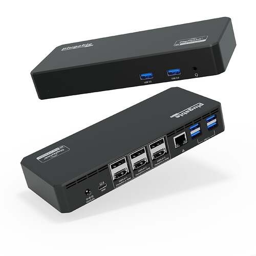

USB4 Dual or Triple-4k@60Hz hub/dock (ud-6950pdz)?
Anybody has any experience with this for Framework 16 on Linux?
My Dell WD19TB (TB3) setup worked with Dell Precision 5540 with 2x4k@60Hz (I guess one of the monitors is in alt mode), but with FW16 one of the monitors is pinned to 30Hz with no option to change.
I’m considering buying this one. Anybody has any feedback?
That Pluggable dock uses a DisplayLink chip.
A DisplayLink chip is essentially a GPU that has been stripped down to the bare minimum for running displays and connects over USB 3.0. (And relies on the main GPU in the system for doing the rest of the work)
This allows it to work even on systems that don’t normally support display output (in fact it can work on all 6 of the ports on the Framework 16, not just the 3 that support display output), however it does result in a bit of visual artifacting and latency. Many users have also reported stability issues with the DisplayLink drivers.
In my experience the Dell D6000, which uses the same DisplayLink chip as that, works well with most devices I’ve tried. I haven’t tried it with the FW16 but if you’d like I’d be happy to test it in a couple hours.
D6000 is ancient. I didn’t pick it even against WD19TB 4 years ago, because of how old it was at the time.
I’m looking more for TB4/USB4 with 2x or 3x 4k@60Hz (2x minimum), since I also need at least a USB 3.2 port for a 3.2 hub for all the accessories.
The chip that it uses for driving the displays is the DisplayLink DL-6950, which is the same chip as what’s in the Pluggable UD-6950PDZ that you linked.

I guess I’ll try this one then:

If you want triple monitor and high refresh and resolution support, you need to look for MST Hubs that support DSC (Display Stream Compression).

Driving 1440p is, luckily, not an issue. Driving 4k@60Hz apparently is. I don’t care about going more than 60Hz but at 30Hz there is a perceptible annoying lag on window dragging and even text typing.
Does anyone know if Framework 16 actually has DisplayPort MST?
Tried this one. Found and filed 2-3 more amdgpu bugs in the process (including one driver lockup requiring reboot).
Both screens eventually initialize but EDID pins them at 30Hz max (with options for 25Hz etc). Also judging by the dmesg Thunderbolt fails to initialize:

So it’s not the cables. UD-4VPD is still stuck at 30Hz on each screen at 4K.
Trying Anker 568 with 2xDP, will report ASAP.
Anker 568 works out of the box with 2x4k@60Hz via two DP-1s.
The only downside it seems is that this is a 1GbE dock, not 2.5GbE, but otherwise it is working perfectly so far!
Thanks everyone for your help!
Oh no, I lied…
One of the monitors is refusing to switch to 60Hz even though the EDID option is there.
Nevermind again. Updated Anker FW to 1.39, enabled Freesync on both displays, unplugged, plugged back in, both are now at 60Hz!
