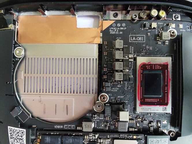

I am a proud owner of a new Framework Laptop 13 with Ryzen 7 AI 350 CPU.
Previously I had a Dell XPS13 9360 with Intel Core i7-8550u CPU and did some mods with cooling and powerlimits and same I want to do with my new Framework Laptop.
Call me crazy, but here is what I did:
Steps:
remove the Fan and cooler and cut off some of the fins:
cut a hole in the Body:
liquid metal:
Cppper blocks and coldplate:
Radiator with Fans:
Ready:
eGPU is a Razer Core X with a GeForce RTX 3090 (also watercooled)
The hole setup is completely silent (two 120mm Noctua fans on the radiator and Framework Fan @ 15% fixed) and CPU stays below 75°C even in Cinebench.
