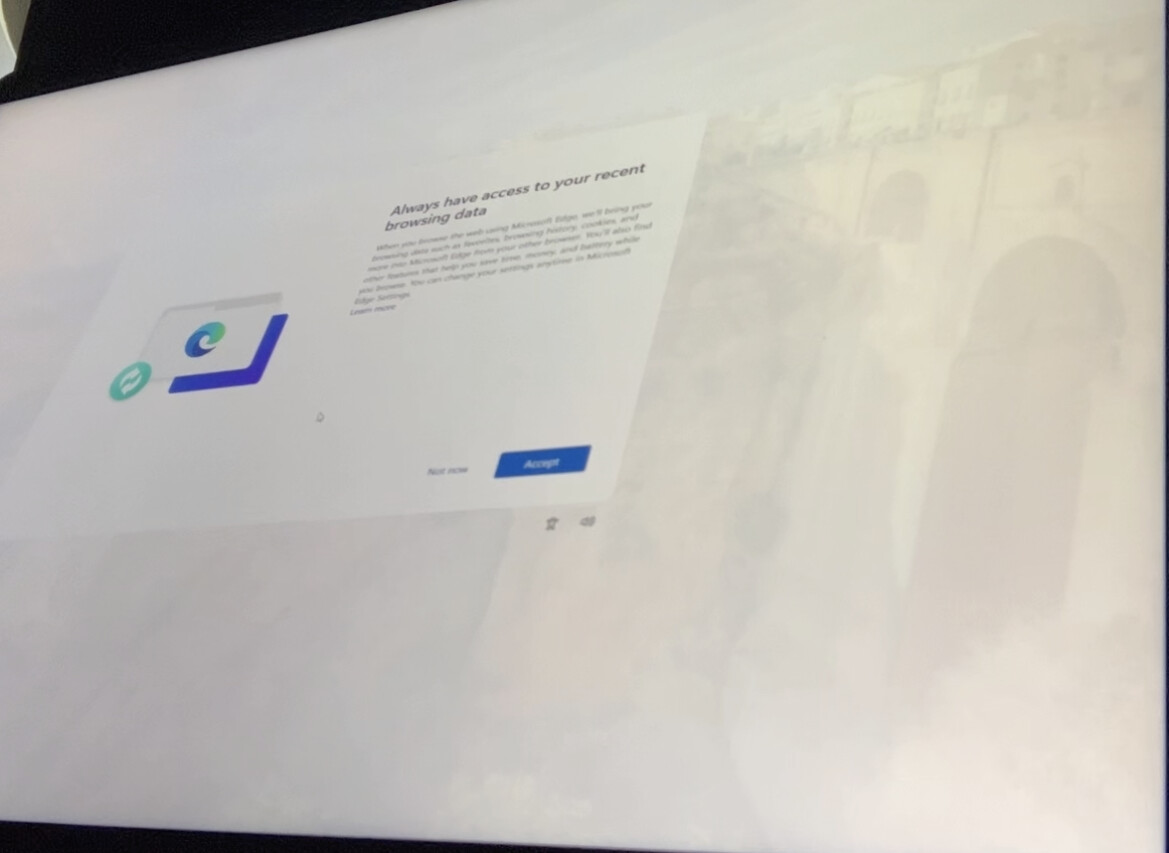

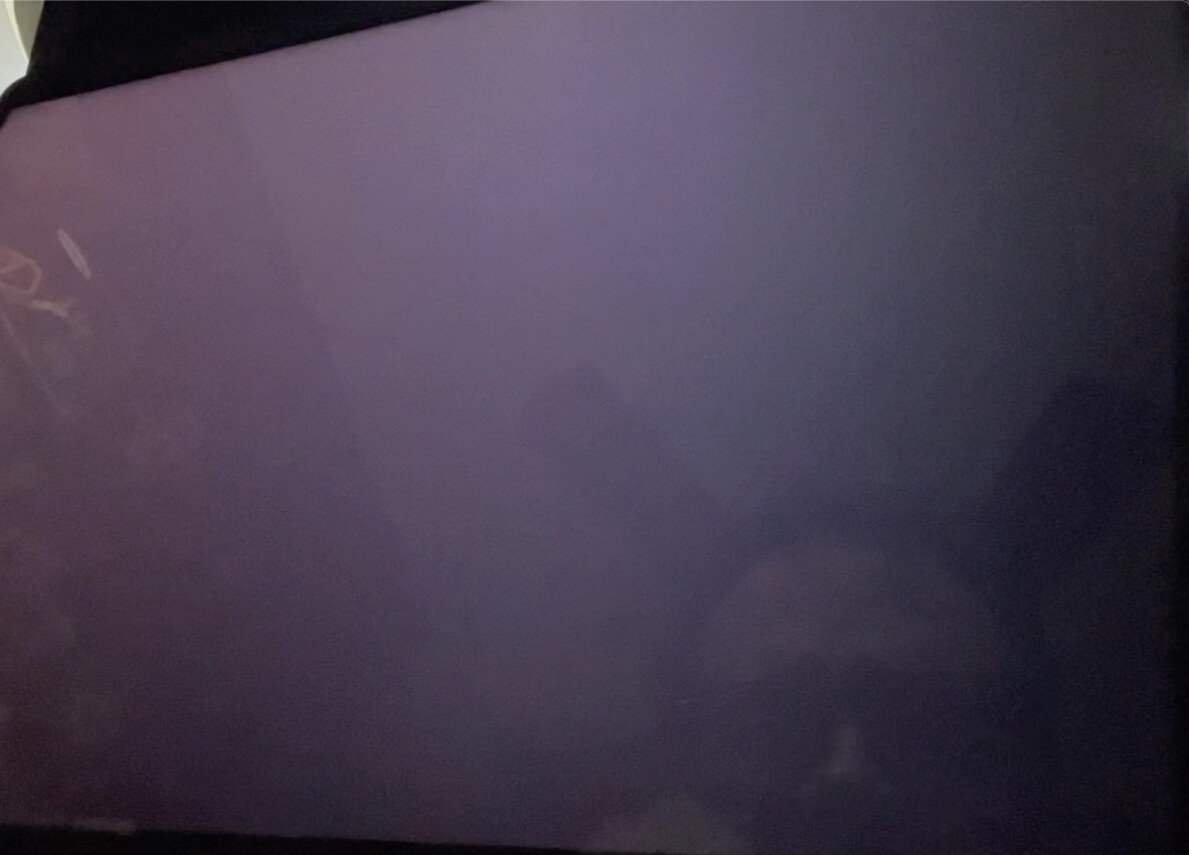

Okay, I followed the instructions here to jump into boot device selection by holding down F12 as it restarts, reselected the USB Windows Installation Media, chose to erase everything and install Windows 11, and got to a slightly different place in the setup process before the same thing happened. The driver must have installed in the background, the monitor goes to a higher resolution, and then WHAM, it black screens and never comes back.
Nice. /sigh
Full screen before drivers
Snaps to higher resolution with drivers for a split second
Black screens & my Framework is a really bad mirror
Sorry for the crappy pictures. I set my phone’s camera up, selfie side, to film the install in case this happened again.
