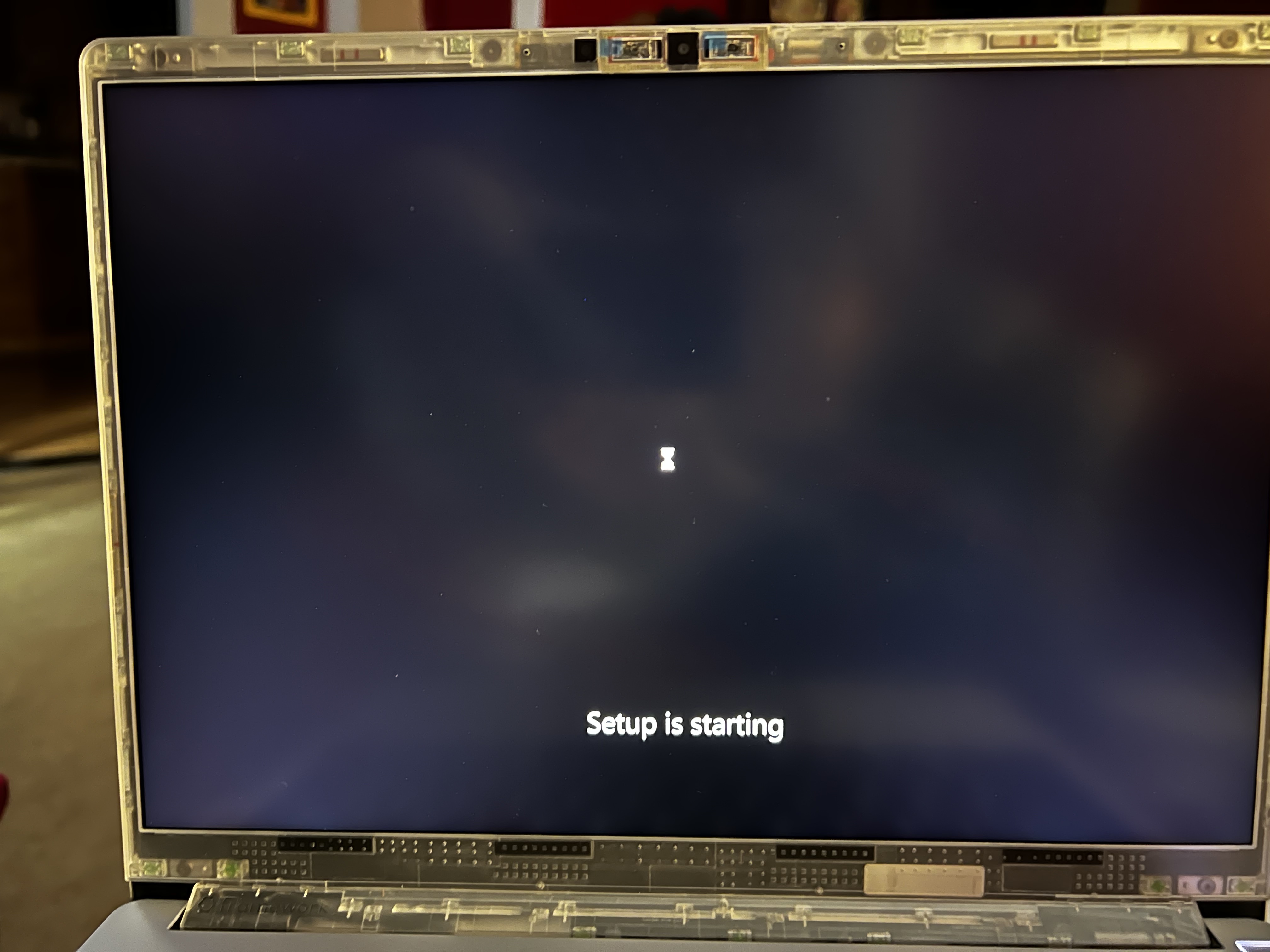

I installed UUbyte & used it to burn the Windows 11 iso file onto my USB drive from my husband’s MacBook. But when I try to boot the Framework from the usb, I get a message that drivers are missing. Can someone help or should I contact Framework support?
I boot to the usb drive & this blue window opens up. I choose next
And I choose Install now
Installation starts
Then this message opens

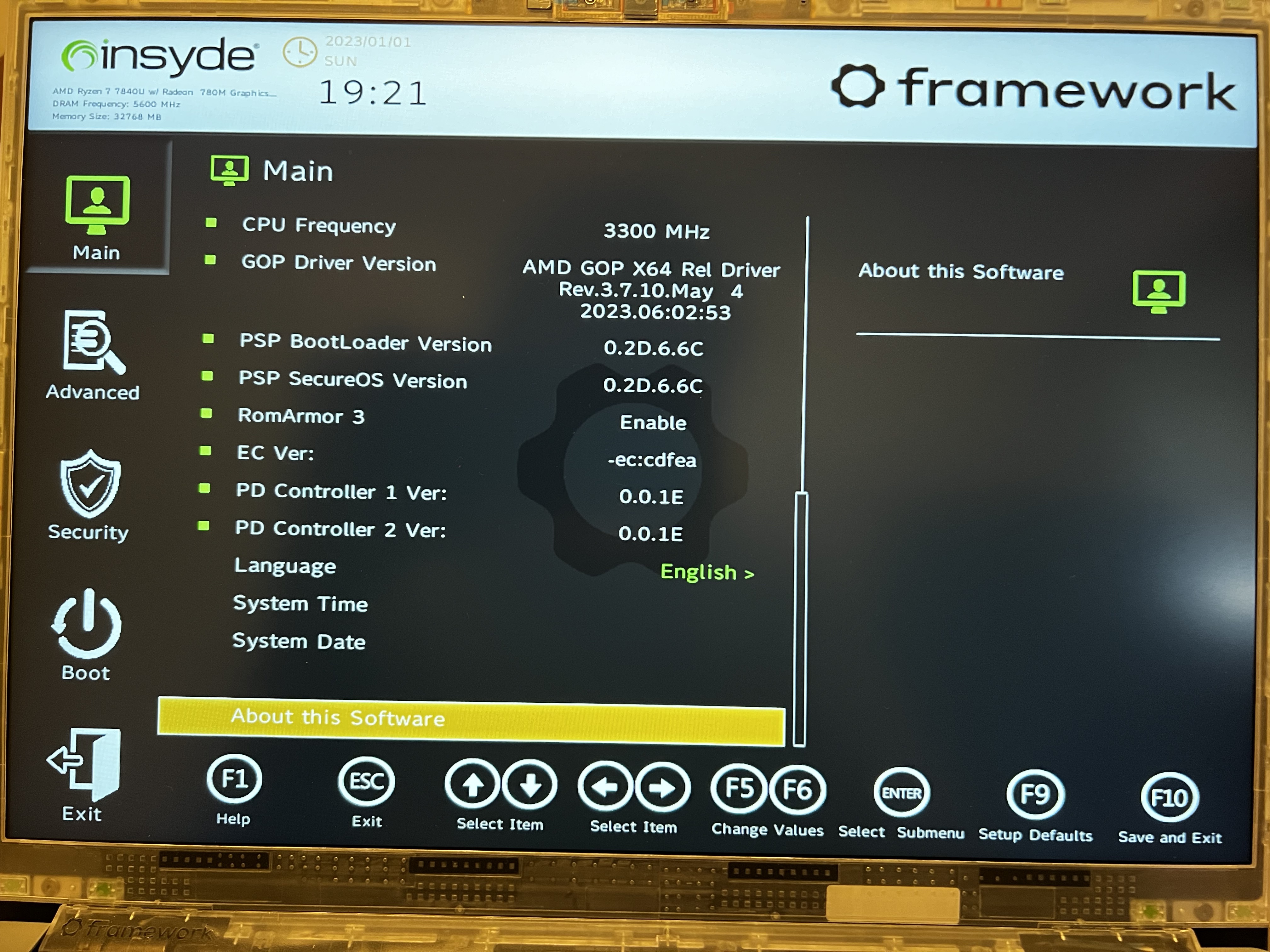

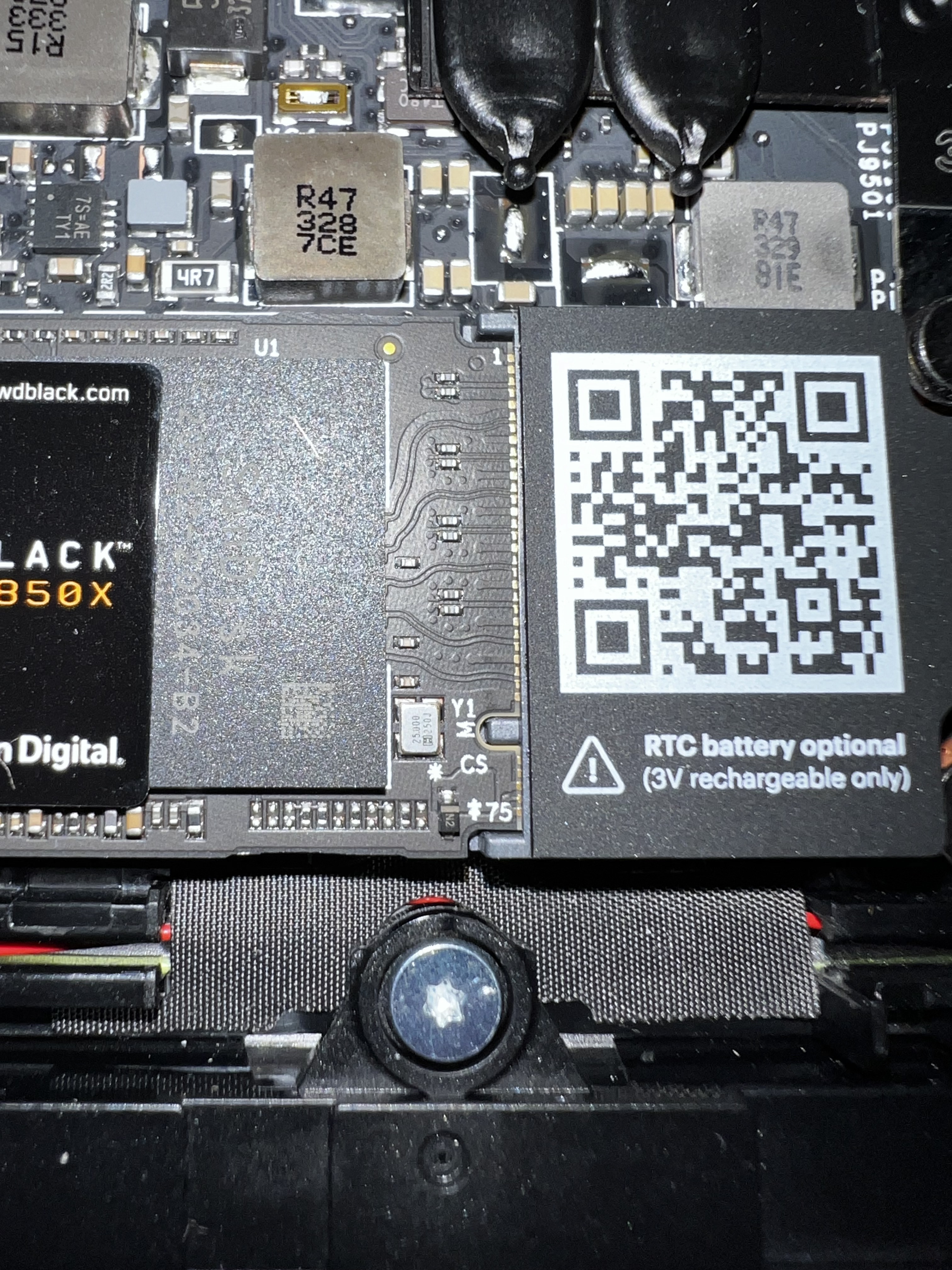

It looks like the installer isn’t able to locate your hard disk. Are you using a Framework-supplied one or did you bring your own? See if it’s being detected in the BIOS. If it’s not, try re-seating it in the m.2 socket. They do require a modicum of force to insert correctly. You shouldn’t see any of the golden pins if it’s completely inserted.

That makes things simpler. Try the re-seat if it’s not showing in the BIOS.
Same results
Still says “A media driver your computer needs is missing”
Media driver missing is usually not a hardware issue but an issue with the USB drive. I’d usually recommend Rufus or WoeUSB if you’re on Linux, but since you’re using a mac… Maybe there’s a different setting in UUByte you can try? Or you can get your hands on another computer to flash using Rufus

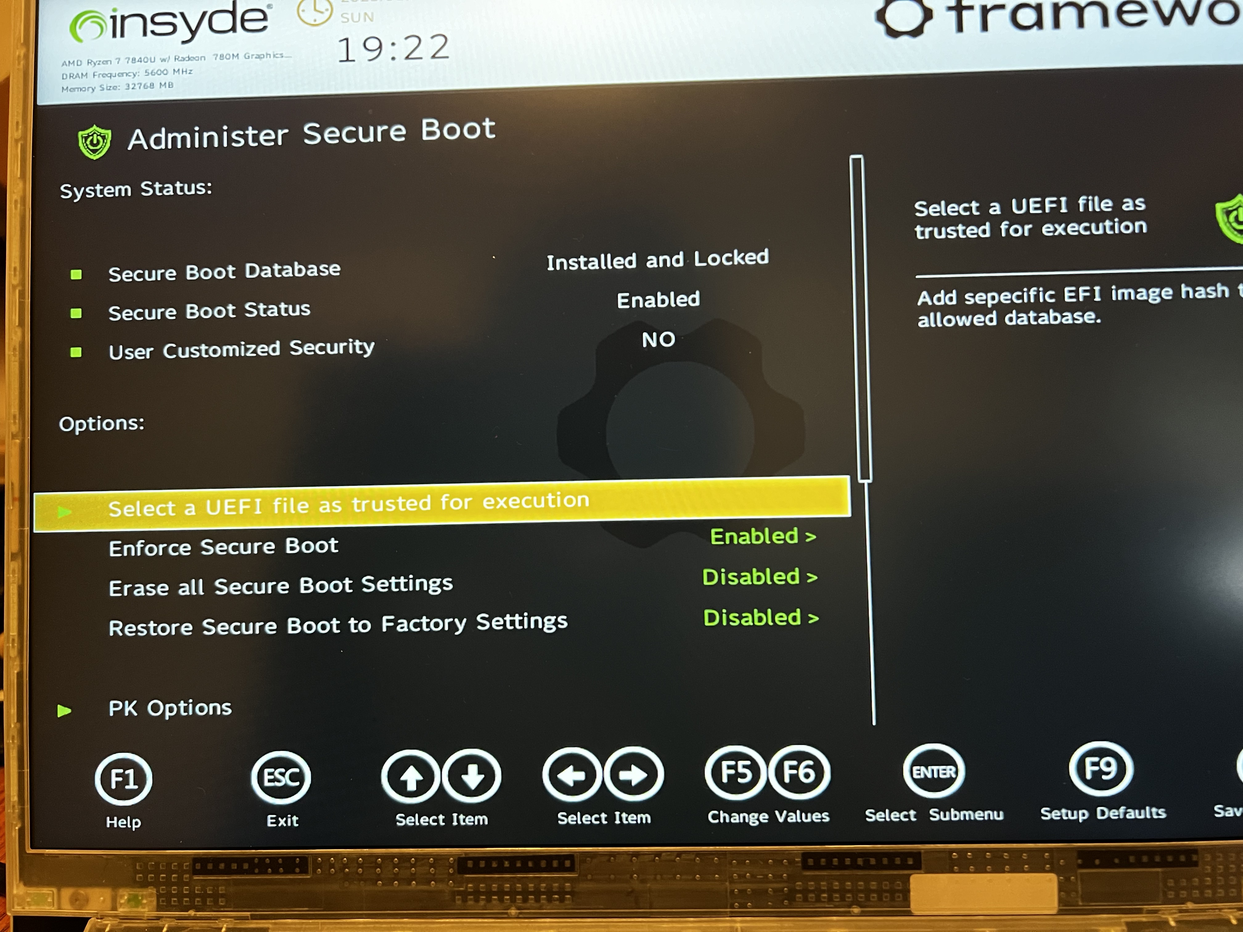

The only place I see my SSD mentioned is in the boot devices menu, it’s not mentioned anywhere else.
I would make sure to use Partition table MBR and type FAT32.
