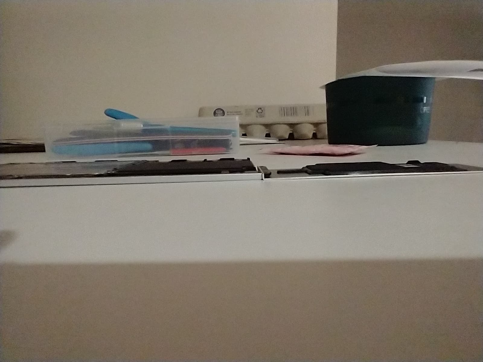

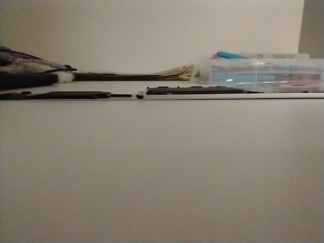

I do actually
Hopefully, you can see it. I placed the spacers next to it for comparison.
In my recent reply, I posted some images of the touchpad next to the spacers.

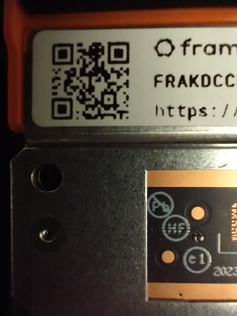

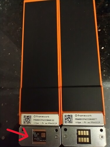

I also noticed this other thing, one of the keyboard spacers seems like it’s missing the gold connectors. Here are some images:
Regardless of which side I place it, It’s not getting picked up. The other one works. On the screen that checks the modules, the one that displays after booting, the one that’s missing the connector doesn’t show up

Ummm…well that’s hard to argue with! Boy, how the heck did that get through QA? I hope it didn’t create a short that damaged something which is why none of your inputs work, though the detection sounds like it’s still working so maybe not. Have you tried without that one at all? Maybe it’s not a dangerous short, but enough to kill the IO signals?
It looks like a lack of quality control. It’s not the first post about quality issues. I even found one YT video with Batch 1 Initial Impressions, check it out here: https://www.youtube.com/watch?v=5NBfhv37EoA
Looks like it was just assembled incorrectly… Saw that in some other thread as well. You should be able to disassemble the spacer and the contacts will likely be on the flip side…
How this got past QA is anybody’s guess, but excrement occurs.

The spacer has 2 screws holding the board on with the contacts and you should be able to flip the board. Then screw back down. Obviously the gold contacts should be down.
